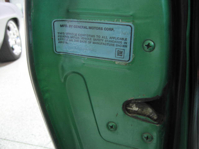

------For education purposes only could someone tell me why the "door-latches" were commented on??? I can barely see them in the pics.......Bill S

The latch assembly and striker are installed prior to painting, and therefore should be body color.

-----Steve, Thanks for the quick comeback! I was thinking door-handles for some reason........Bill S
