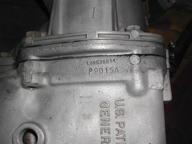

Default Re: L72 Big Cars
On the build stamp on the trans it should end in a letter A=M-20, B=M-21, and C=M-22. Not all trans's have this suffix but most should.
Rich.
  #24
Old 01-19-2006, 08:40 AM
GTO_DON GTO_DON is offline
Join Date: Feb 2003
Posts: 3,072
I THOUGHT THAT WAS 69 AND UP. ONLY THING ON THE SIDE ARE THE DATE CODE AND THE VIN NUMBER.
1969 GTO convert RAM AIR 4spd
1964 GTO convert survivor

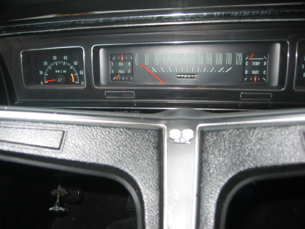

  #26
Old 01-19-2006, 08:43 AM
Join Date: Feb 2003
Posts: 3,072
ANOTHER NOTE THE 6000 REDLINE AND THE SS427 ON THE WHEEL

  #28
Old 01-19-2006, 06:06 PM
Enoch Enoch is offline
Banned
Join Date: Feb 2003
Location: USA
Posts: 6,747
Thanks: 260
Thanked 123 Times in 64 Posts
I believe you guys are right. I wasn't paying attention I thought it was a 69. Here is a picture of a 69 trans stamp I have . I will post a picture of a 67 with no stamp later.
Don getting back to how can I tell if it a M-21 or M-22. I have not been in a "QUIET" M-22 car. Does the trans wine at all.
Rich.
