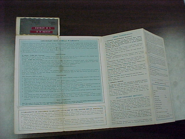

Yes..They used the letter "0" for October,"N" for November & "D" for December.They ran out when using numbers 1-9.
That is a November VIN#,on an October 31st started assembly car.
Just a Note Carmen,that CW rear is a 3:31 NON posi,he never says it is a Posi in the auction,but I just wanted to bring that up.
The Tape should Have GM printed on it,but it is also possible to have an authentic P-O-P that used a generic label maker tape,as we have seen in the past.
What I can't see in the recent P-O-P picture you posted is the word, Addressograph on the side of that metal plate.There are repops out there that do look exactly like the one you just showed,missing this.
Here is a genuine P-O-P I have here as an example.

Another of the POP

Well I guess tarnish proves it is real?
"THE PROTECTO PLATE IS NOT A REPO. IT IS STILL ATTACHED TO THE WARRANTY BOOKLET AND THE METAL SHOWS SOME TARNISH. THANKS. JIM"
