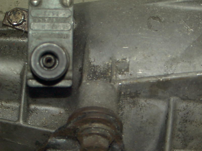

This is out of a 69 chevelle 396 350h.p. This was an all original car that came with a 4;10 rear end in it.It looks like the part number was 6666F N1 See attachment
