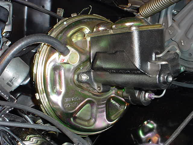

Has the black master cylinder debate ended? Black or gray? Mine is black.

The final verdict is black. Wayne, Tommy K, and I were talking about it when I went to Waynes to go over your car with him. Even the low mile cars look 'gray' because the brake fluid 'seeps' over time. We all know what DOT 3 fluid does to paint, so sometimes it's hard to find any remnants of black paint on even a low mile car.

I am not 100% sure on this but from what I read, the master cyl was painted black prior to machining so the machined surfaces have no paint on them.

Joe, that is correct. A flash coat of black was painted on these and was just enough to keep them from rusting. They were then machined. A combination of the machining oil and brake fluid would leave very little paint intact. When I restore them, I use a cast colored paint and then air brush a very fine 'mist' of black paint. What you end up with is a black part with a lot of bleed through of the cast paint.
