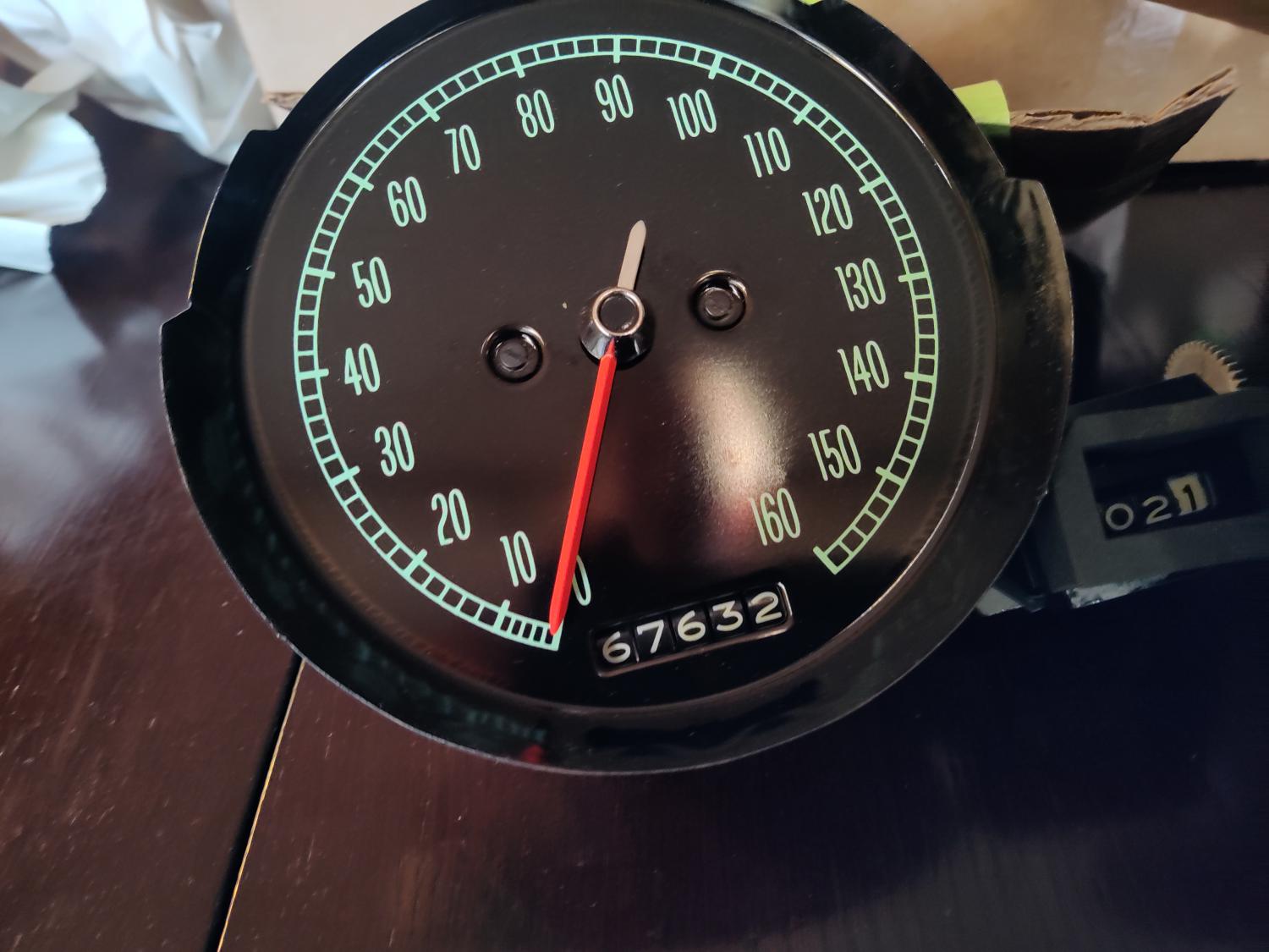

Ha! After drooling a bit over your gauge pod, I looked at the gauges I just received in the mail today.....I beat you by over 2000 miles!!
