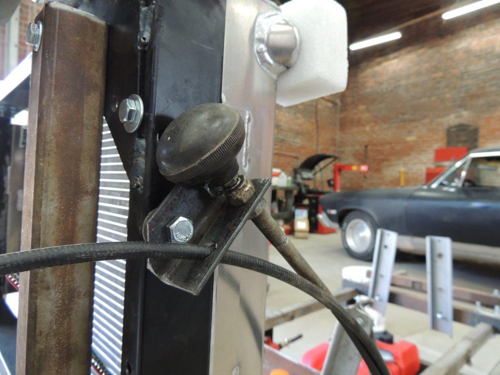

The framework for the dash panel has brackets welded on both sides. I think that makes a great place to mount a throttle control.

Looking at throttle control cables. I can really go overboard on this (as far as using salvage or scrap parts) and use the old knob and bowden cable assembly that I took off my 49 Studebaker dump truck when I converted the hydraulic dump control from PTO to an electric over hydraulic set up.
But for this I think I want a new part; something with a handle and lever so I can control throttle opening more precisely.
Can't find much other than lawn mower, marine and heavy equipment controllers.

Decided to just use the old PTO cable and handle from my Studebaker. It is 75 years old and way over built. Very thick cable. Moves freely, and I can cut it to size once I have everything dialed in. I can get about 4 inches of travel out of it, but shouldn't need that much.

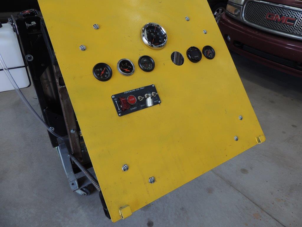

Got the cutouts done for gauges and control panel. Control panel has a master switch and three accessory switches.
Also has a built in push button for the starter.
Have an extra gauge hole. I bought a dual Air Fuel Ratio set up thinking that it included two gauges. Well, it does, but BOTH gauges (left and right) are contained in a single pod.
I have a volt gauge on the way, and may mount a fuel pressure gauge.
If anyone wants a vintage RAC (made in Japan circa 1971) Amp gauge, it is yours for free.
I have no use for it.

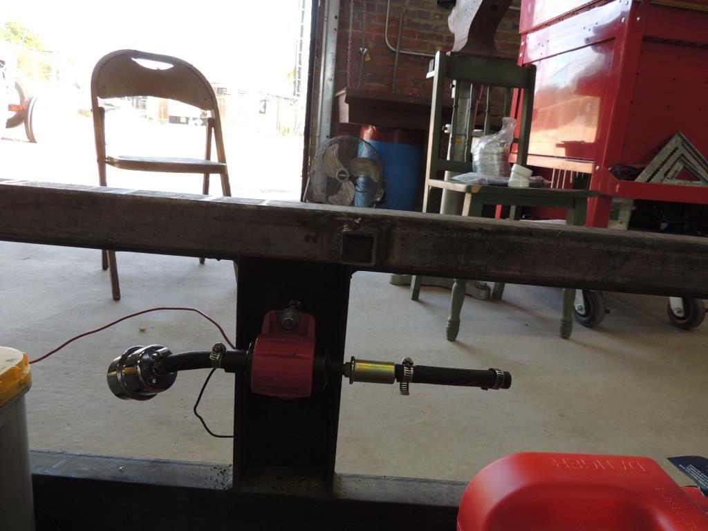

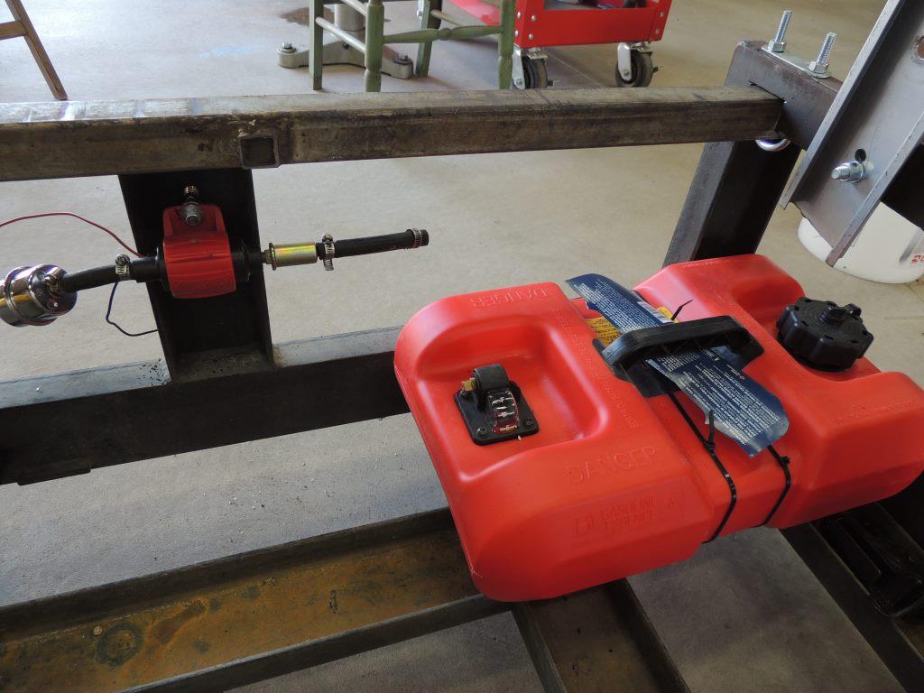

Also mounted a low pressure fuel pump for carb applications that will be using electric pumps. It will go on circuit 3. I started to mount it on the outside, but figured it would be safer on the inside. It is right next to the fuel tank. Just need a couple of 90 degree elbows to get fuel to it.

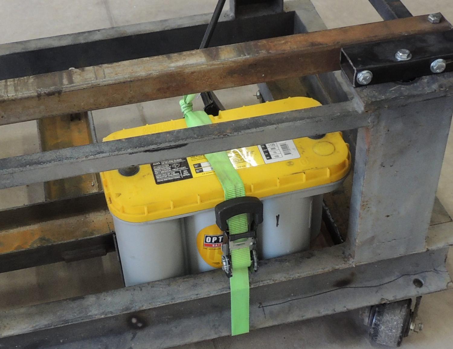

Forgot to mention that I made a mount for the battery. Welded in two pieces of angle iron. You can see the burn through, so I know I got good penetration.
Laid a piece of 3/8 plywood on the angle iron, then put the battery on top.
Keeping with the budget build, I just used a left over ratchet strap for a hold down.
