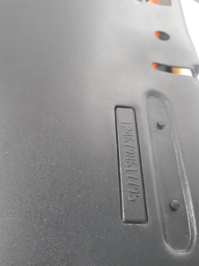

Dam. I have not checked this thread in a while. I realized the importance of saving the dash and not touching the original VIN. I fought with the body shop that had the car. They wanted to replace the dash with a complete repo top.

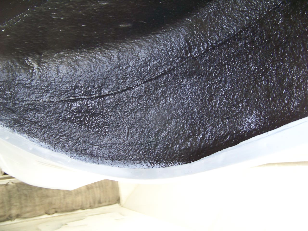

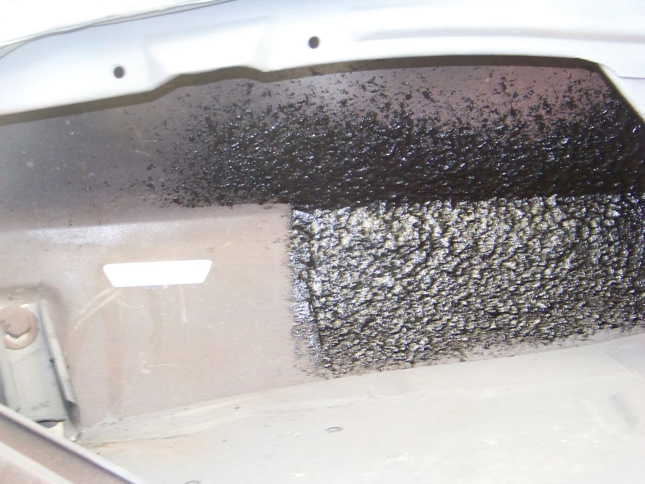

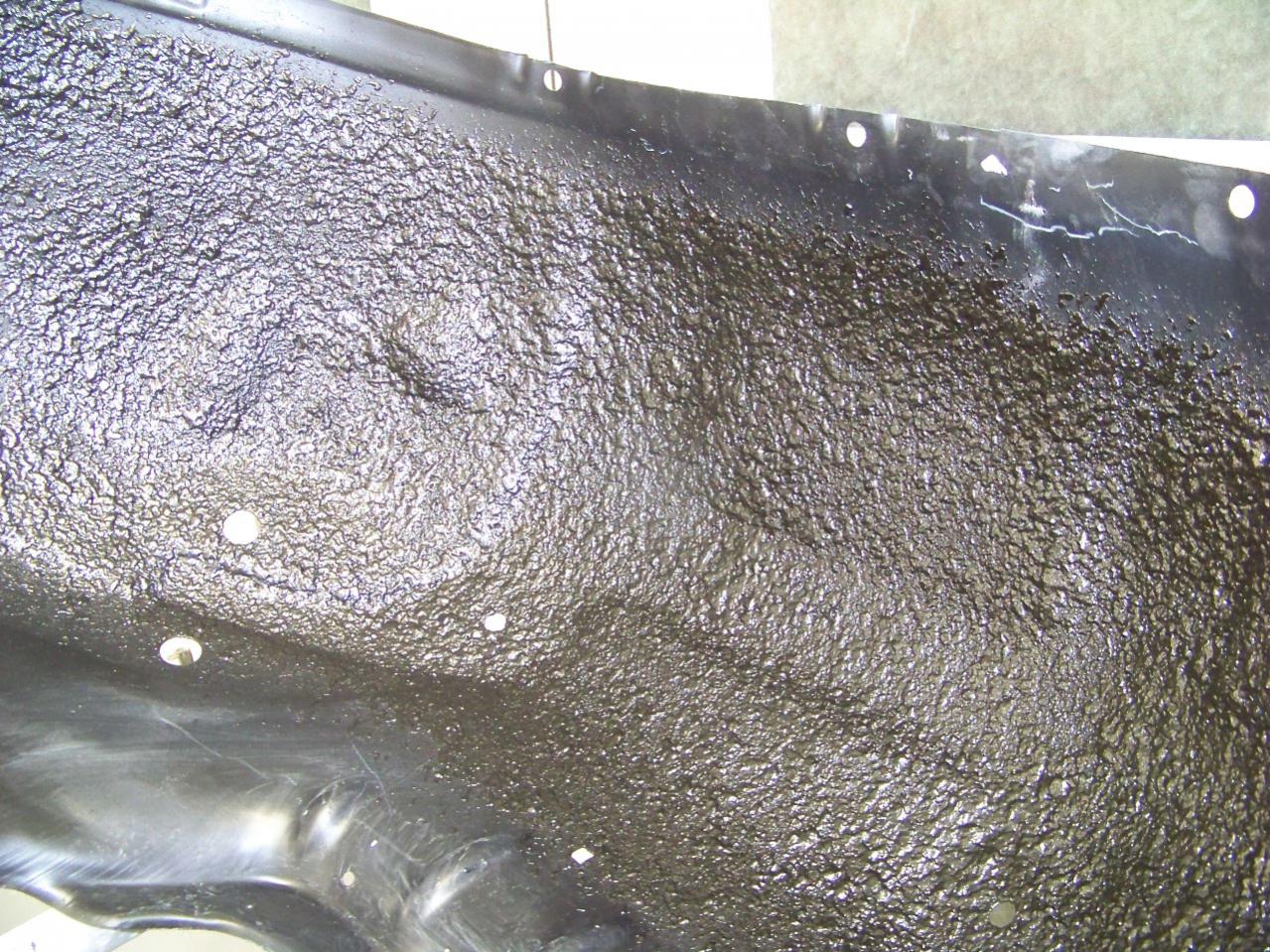

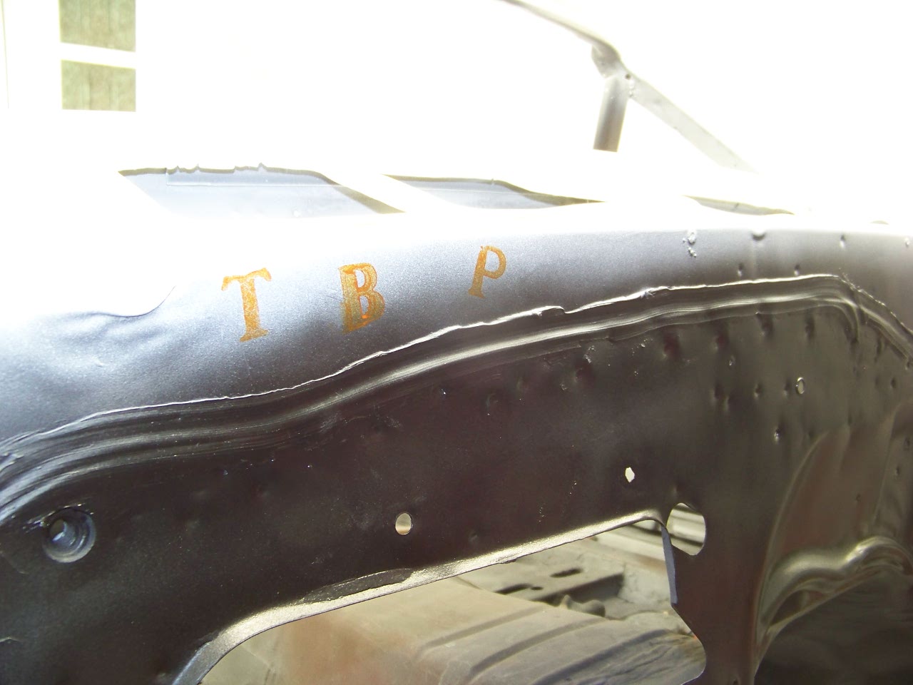

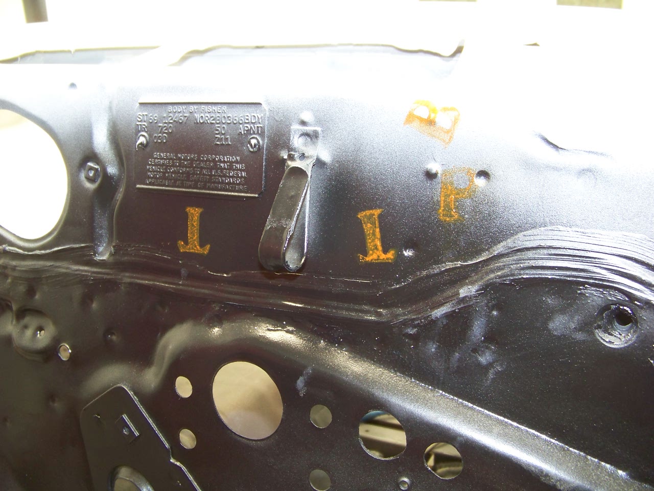

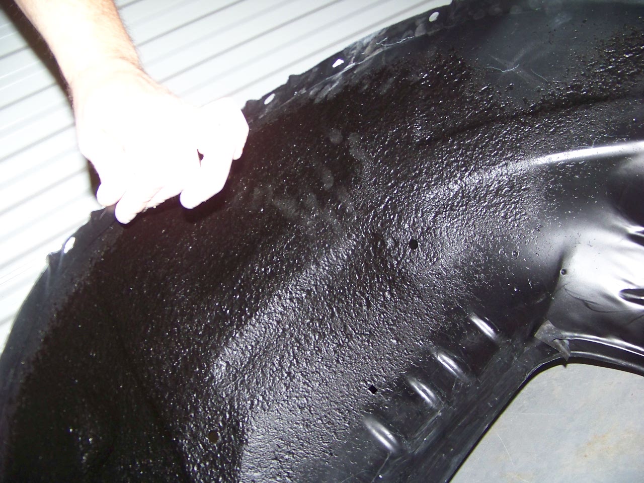

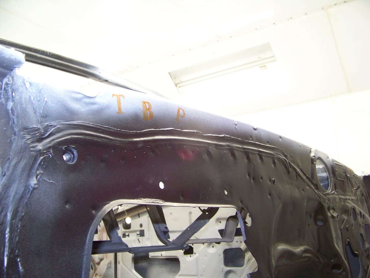

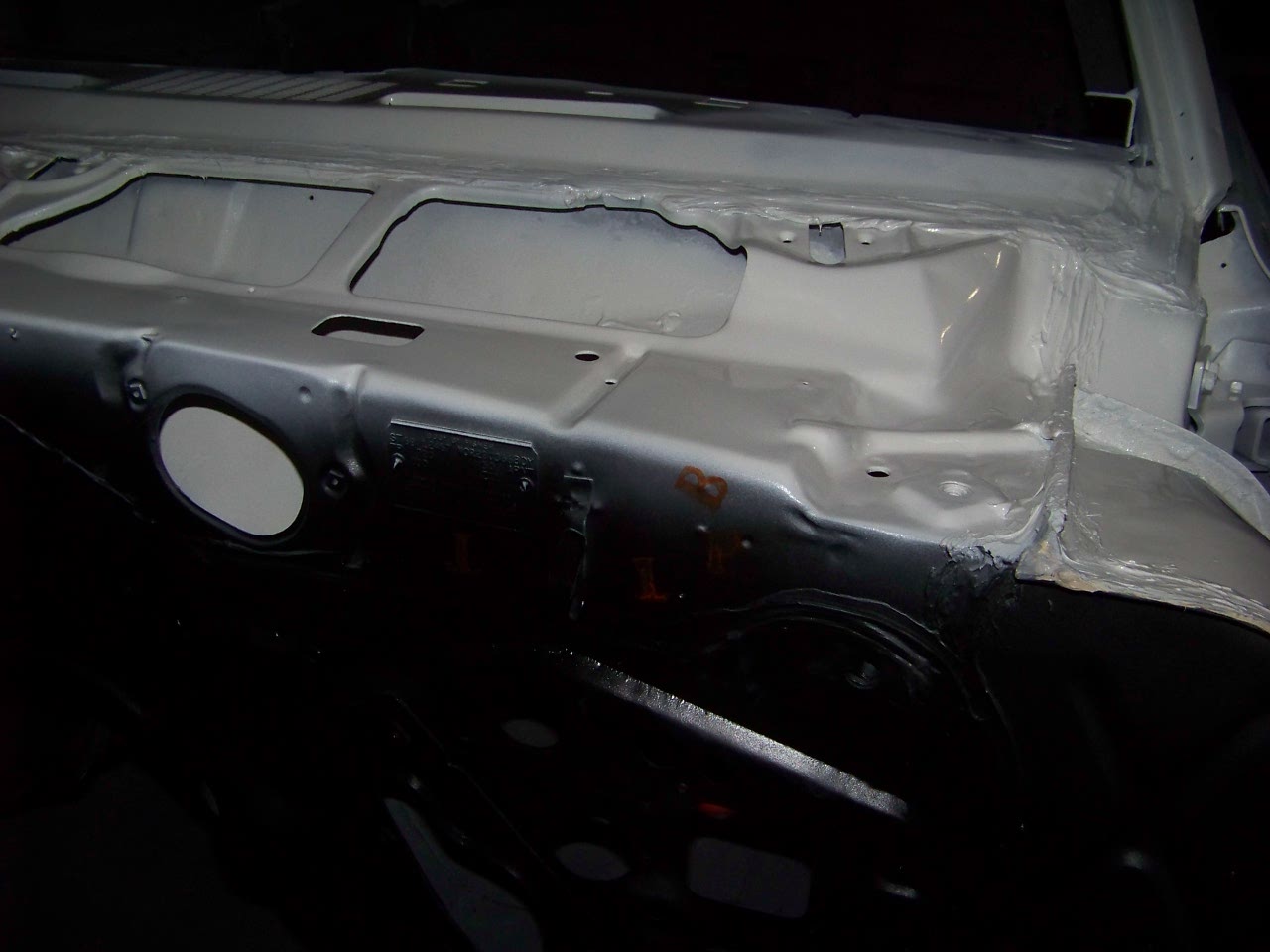

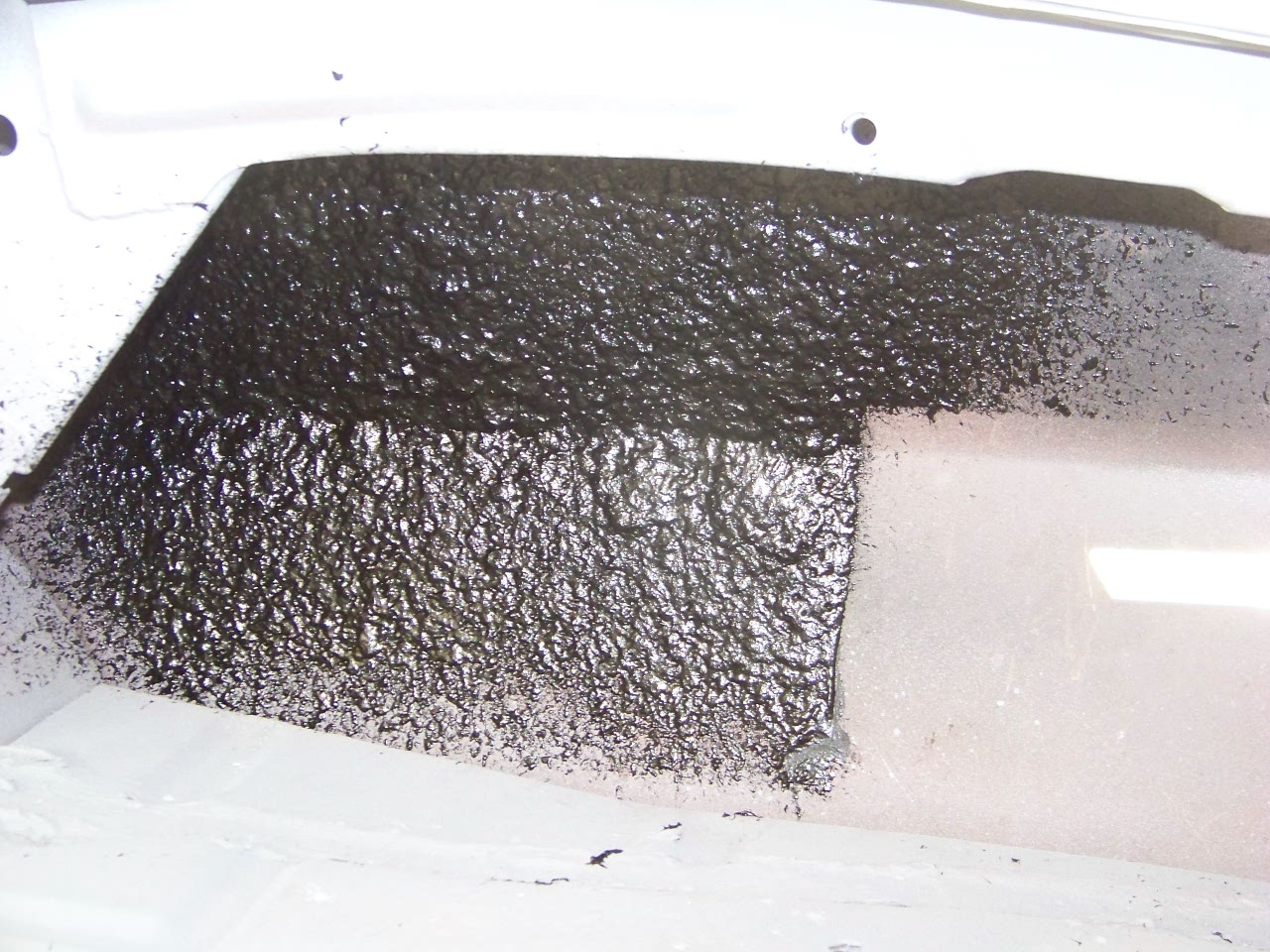

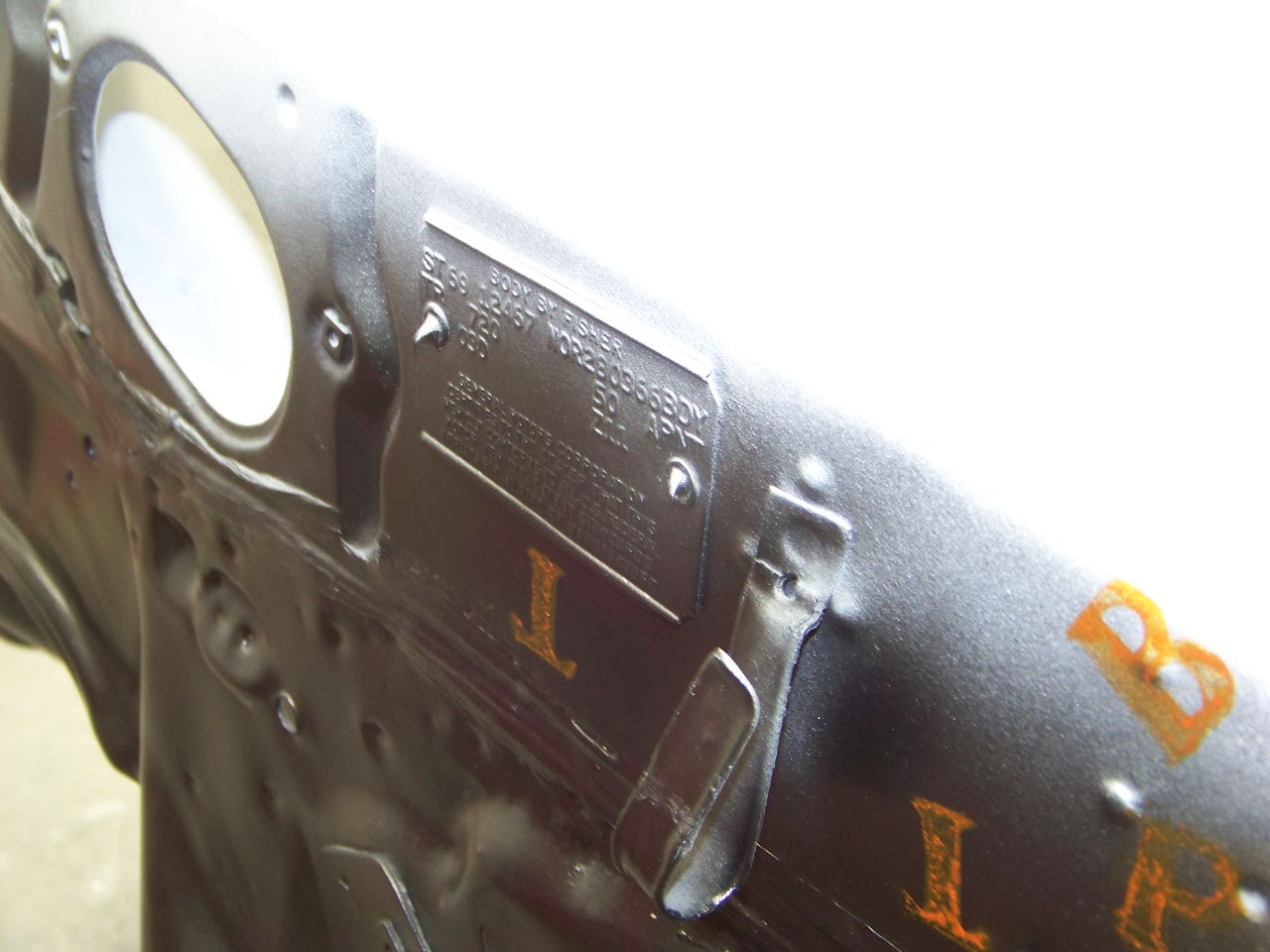

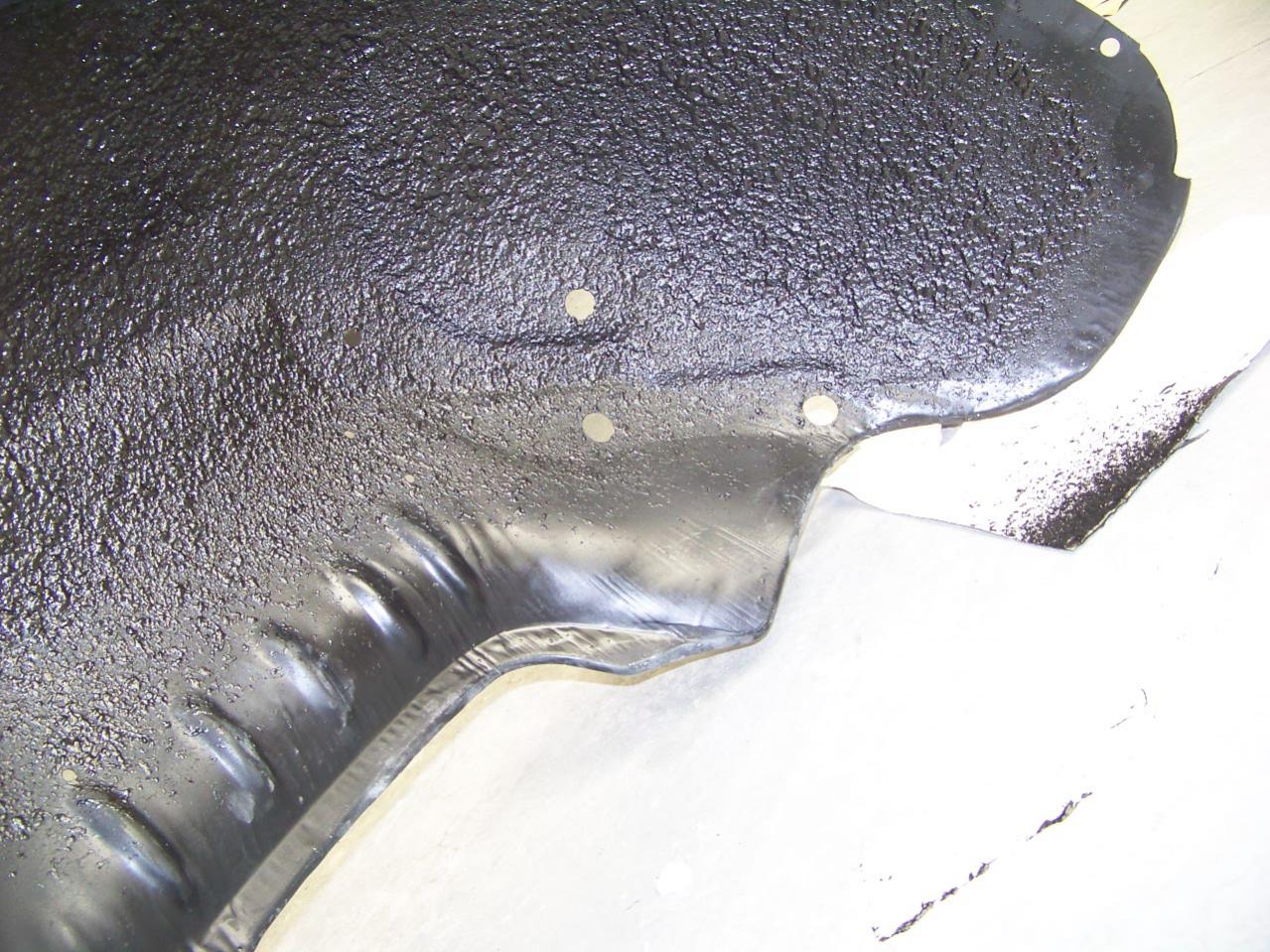

Here are some shots of the ashphalitic undercoating in the wheel wells and trunk. also the firewall and cowl with the PTB stamps.
There is so much light in the booth with the white on the horizontal it creates such a hotspot it's difficult to get how nice the transition mist is at the top of the cowl...
The PTB is a permanent heavy bodied ink, not paint.

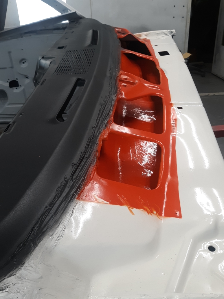

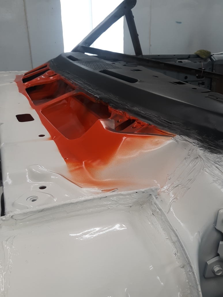

I had to turn the lights off to get a decent shot of the wiper cowl and dash.

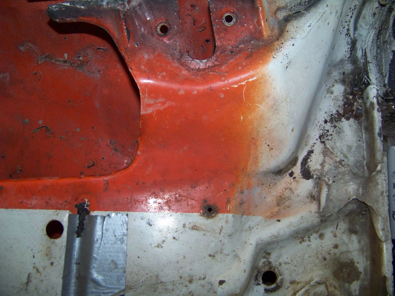

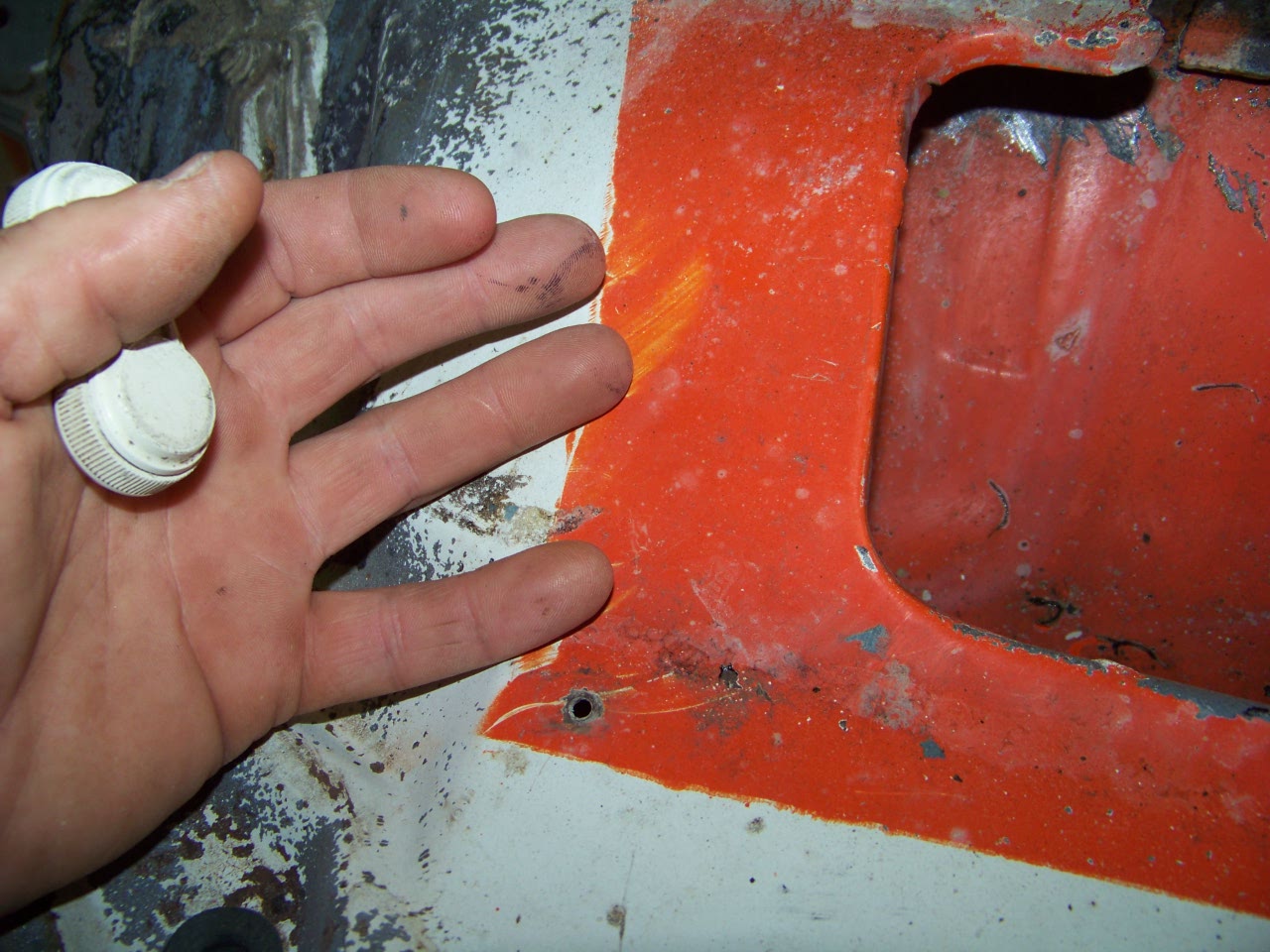

Orange in the wiper well - with the anomalies like the original.
Including some finger marks - lol
because the VIN was stamped after the body was painted the paint chipped out -
I use a needle in an exacto knife and carefully chip the paint out so it appears factory.
