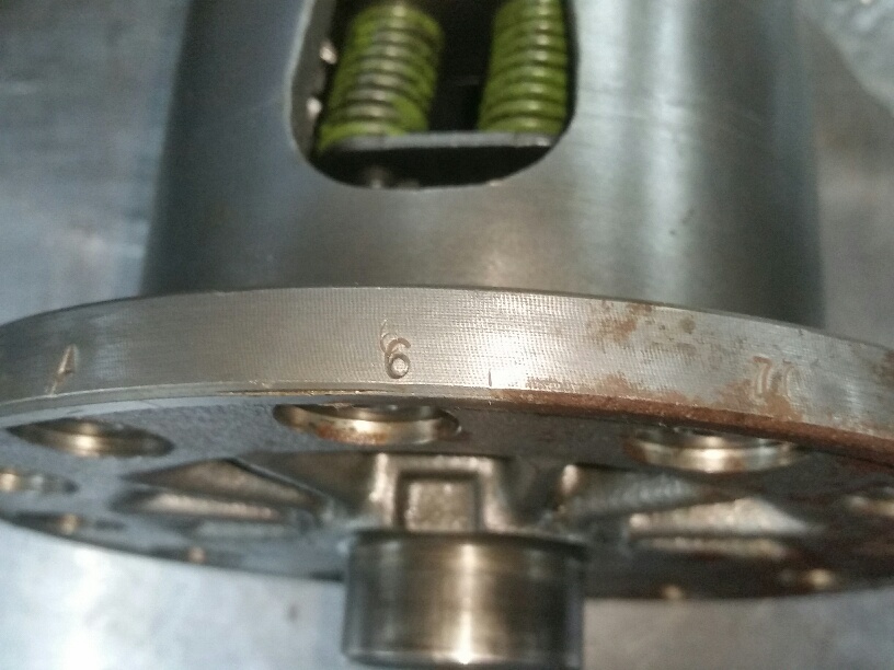

I'm going to bring this up again. I've got a 12 bolt 2 series Eaton Posi with a code that looks like A 6 70, but could be A 6 7C. Did they change from a letter code to a number code for the year in '70?

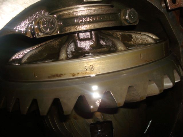

rear end date

Thank you SSL78.
That shows I was used for both the month and year.

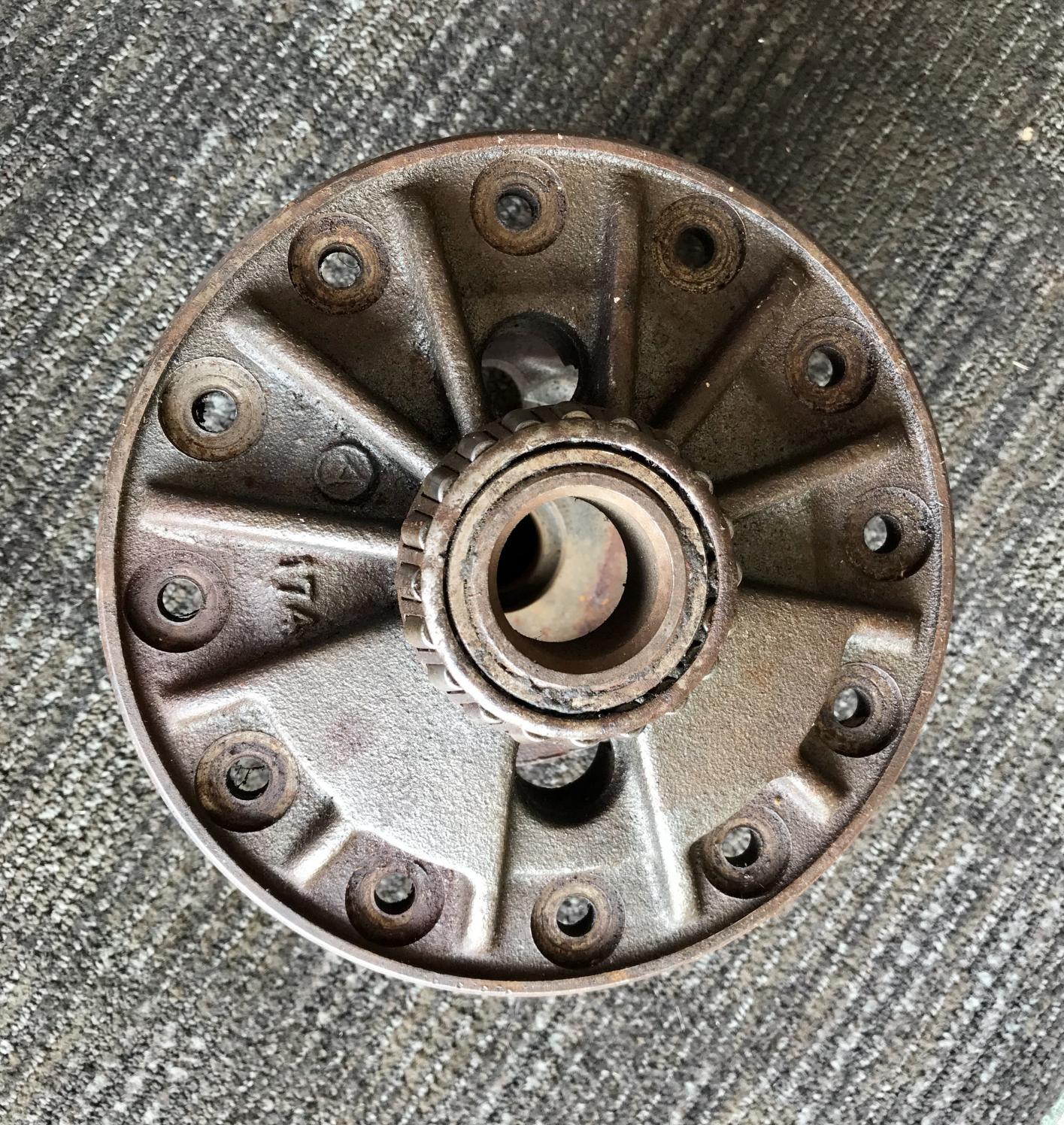

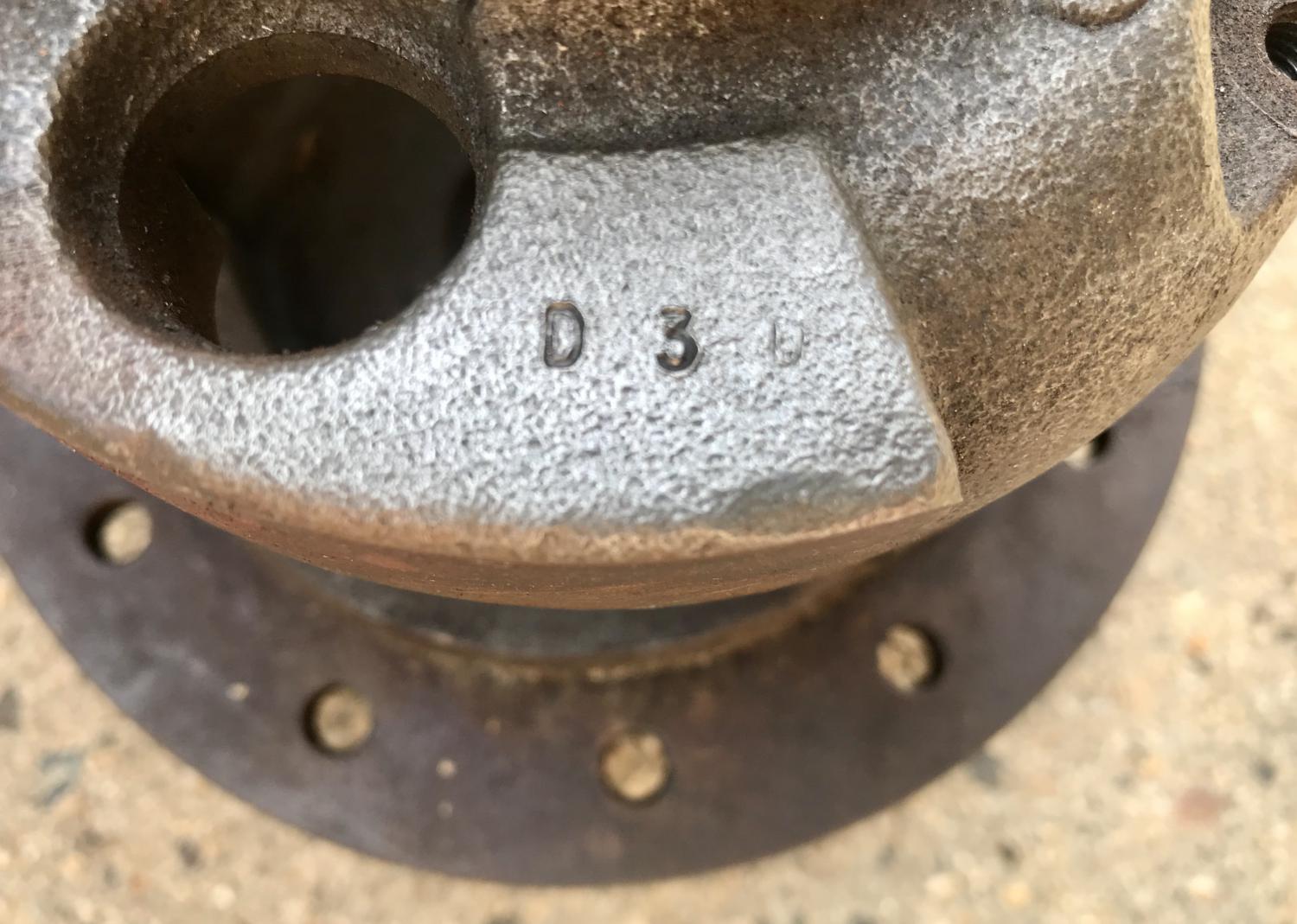

I’m bringing this thread back to the top because I need help with a date stamp. It looks to be D 3 D, which would be April 3, but I’m not able to figure out the year.
