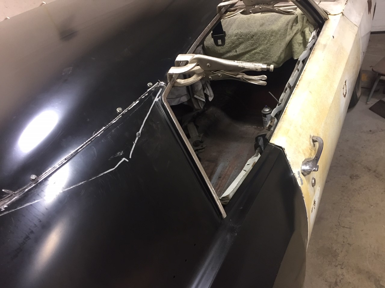

Did some more work over my holiday break. Driver quarter is finished. New roof skin installed. All the seams filled with Mar Glass just need to finish with a skim coat of filler. As you can see in the one picture the 70-72 chevelle roof skin had to be trimmed to fit the Monte roof line. Wasn't to bad I just took my time trimming.
Looking for the next project.
