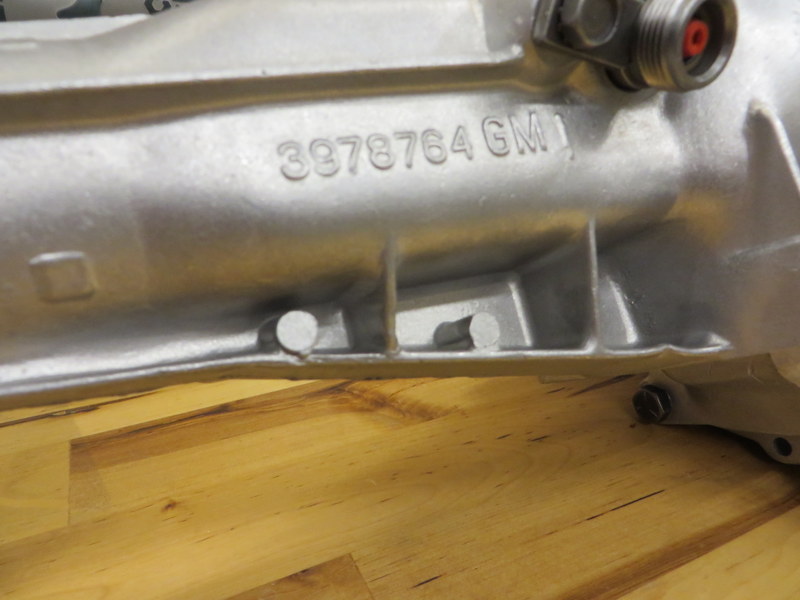

Thanked 208 Times in 136 Posts
heres what cast iron looks like after bake abrade..I had these done for our resident 409 guy Verne....theres nothing on them..no spray no coating..they where still warm when i picked them up ( Verne even asked if they had a coating on them), they looked so good...they are ready to coat..or paint or leave alone..lol...they came out beautiful
next week ill show some alum im having done..
Mark
