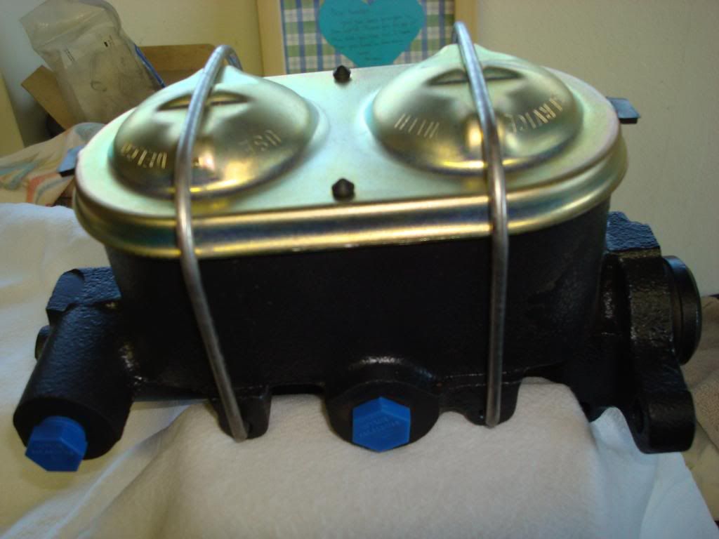

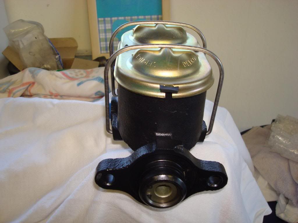

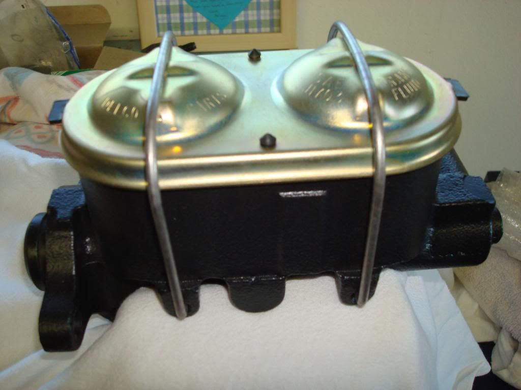

The last owner says this is the correct master cylinder the part # is L2229771. If this is not correct what is?

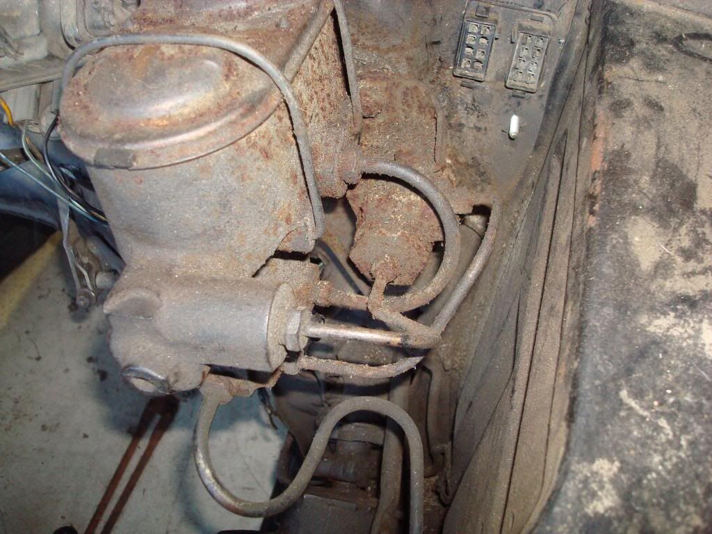

Your master cylinder should resemble this one.

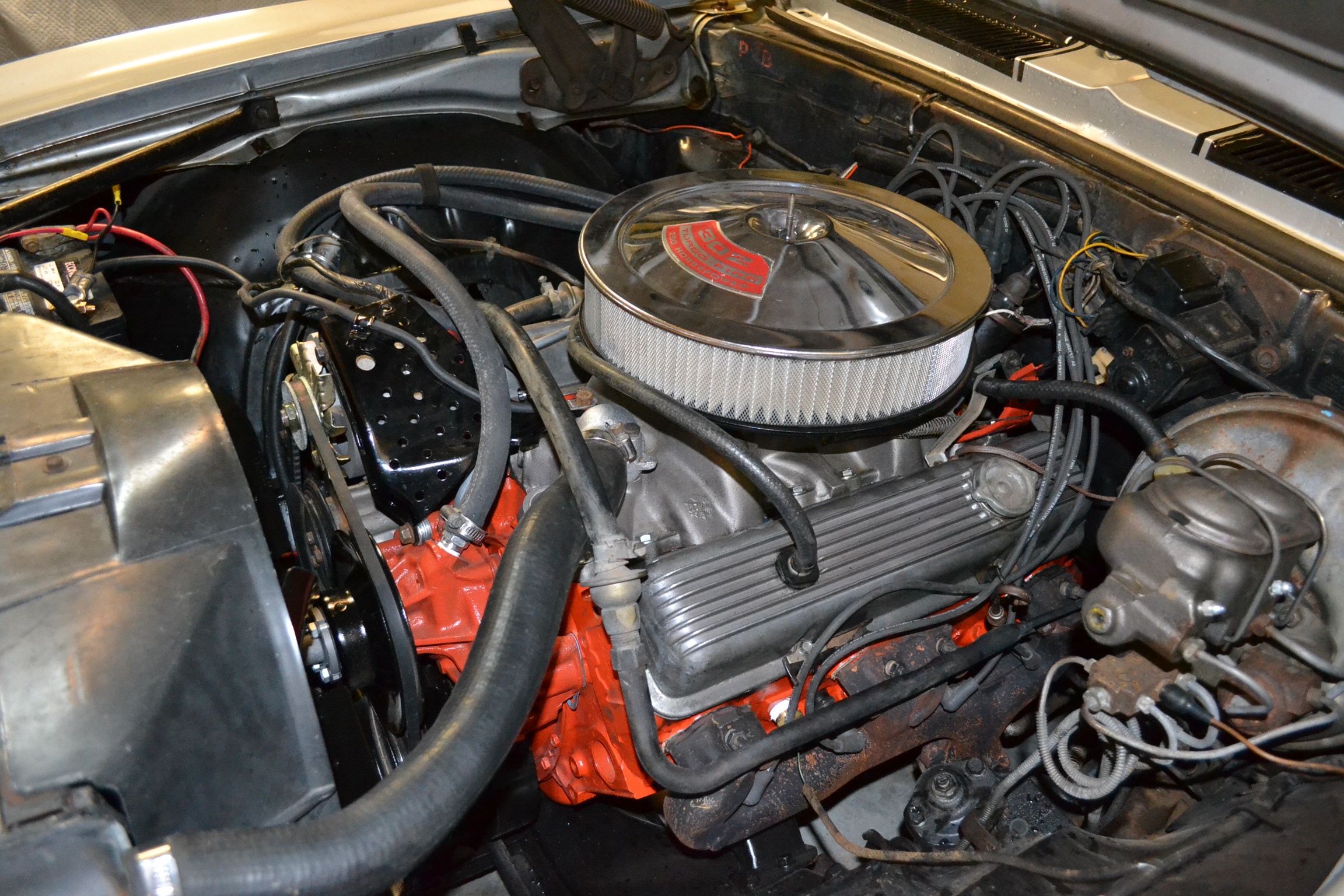

Disregard the remote oil filer in the picture but this is what the J52 non-power assist master cylinder looks like. It mounts level rather than tilted as in the J50/J52 combo. It's shaped slightly different and has no bleeders.

Do you know where I can get one is this one for sale?
