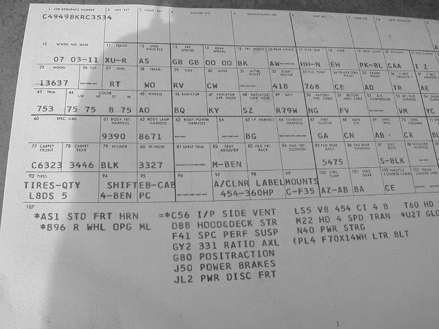

Update, The car was bought new at Sausman Chevrolet before it was Sunderland, I found the build sheet behind the drivers door panel. The hood is the 2nd design and the windshield is clear and does not have an antenna. The spiral shocks have been changed.

Congrats on finding the BS Jeff! Unfortunately the numbers on your dizzy are backwards!

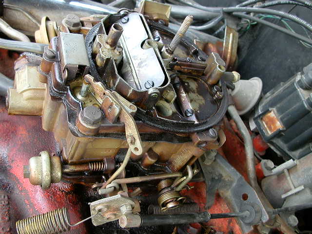

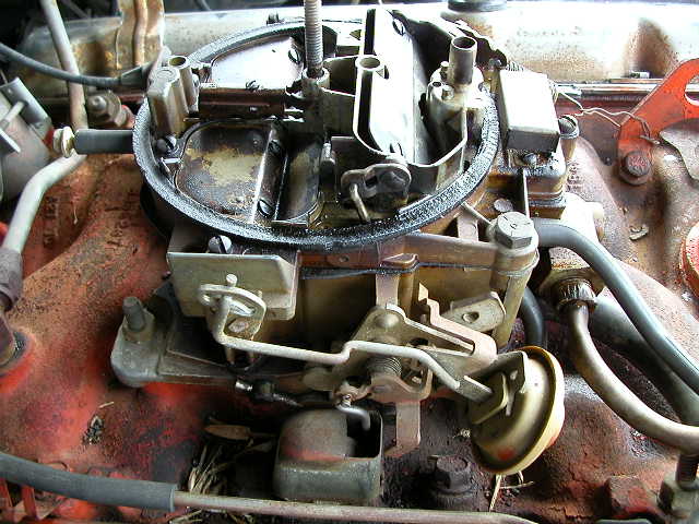

It looks like the TCS unit is missing on the intake.
Maybe a former owner tossed it out.
Is the wire still there, maybe it is sitting off too the side?
That 205 &quot;EH&quot; carb is a very tough carb to find these days.
Nice clean build sheet !!

The car has it's original drivers side assembly line fender and washer bottle. Rare find these days as the replacements are both different. Nice build sheet as well. The distributor is the correct 963 and the 9M22 and is a known date. Another hard to find item. I also noticed the front engine lift bracket has the correct and different manifold bolts. I rarely ever see those in their original form. Sweet car!

Cloth interior is a bit unusual for an SS (at least you don't see it much these days). Looks like the car wasn't ordered with much more than stripes, posi, and power steering.

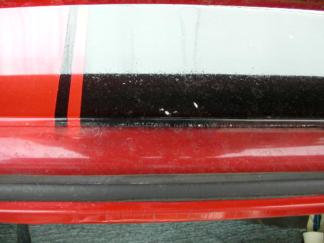

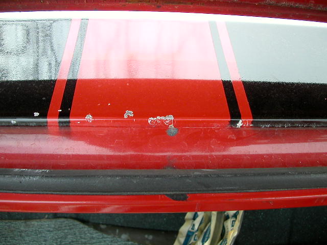

Great pix.
Good stripe detail.
