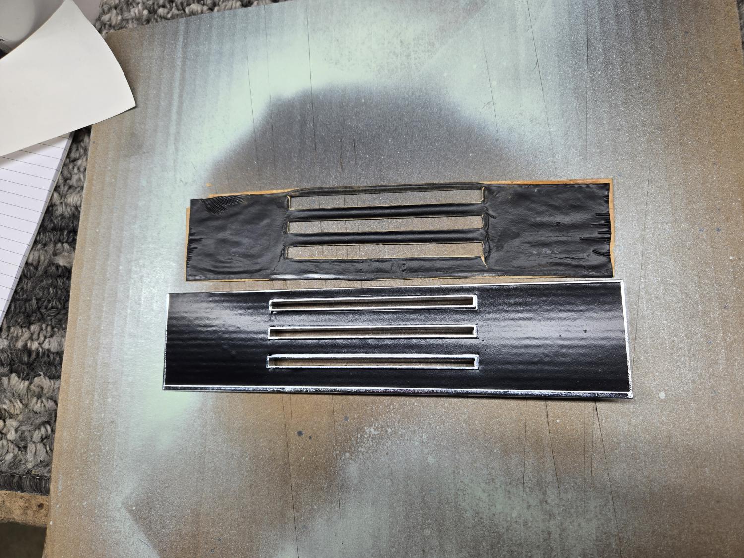

Default Heater Controls
Got into restoring the heather control, and had to make a new black vynil background for behind the lens.
Had to start with some dark contruction paper and then had adhesive backed vynil that I could dye black with interior dye.
I first did the cutouts as the one pictures is the 2nd one i did after making some mistakes on the first.
I show this really simple thing for the humor, as something like this turns into 4hrs before you know it!
