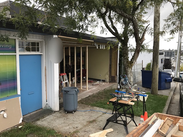

It's been some time since there were some new entries on here. So here is an update! For about four years Lloyd Costley (Edgemont Village)and myself have been looking for a suitable commercial building to purchase to combine our workshops, have some rental space and invest in a property that could give us a decent appreciation over time.
We viewed over 30 properties over the past four years and submitted 6-8 offers that just went no where.
In Nov 2015 we were shown a 3500 sq ft building about to be listed and got an offer in right away. Our offer subject to minimal conditions was accepted immediately with a Mar 1 2016 closing.
Attached are some early photos, overgrown property 50x50 rear yard. The main area is a 2600 SQ ft open shop with 14 ft ceilings in 1500 sq ft, 300 sq ft low ceiling , a Devillbis Paint Booth and plenty of storage in the old office areas, 900 sq ft.
This was a view from the back , completely overgrown
Previous tenant was a sign manufacture, lots of tables, temp walls built everywhere.
Electrical was a nightmare
www.vancouverclassiccars.com
Attachments - The Supercar Registry Shop front rehab.jpg A3F4F0A8-4EA0-418E-AE74-78DFC6964041.jpeg 49515409848_0484096389_c.jpg
