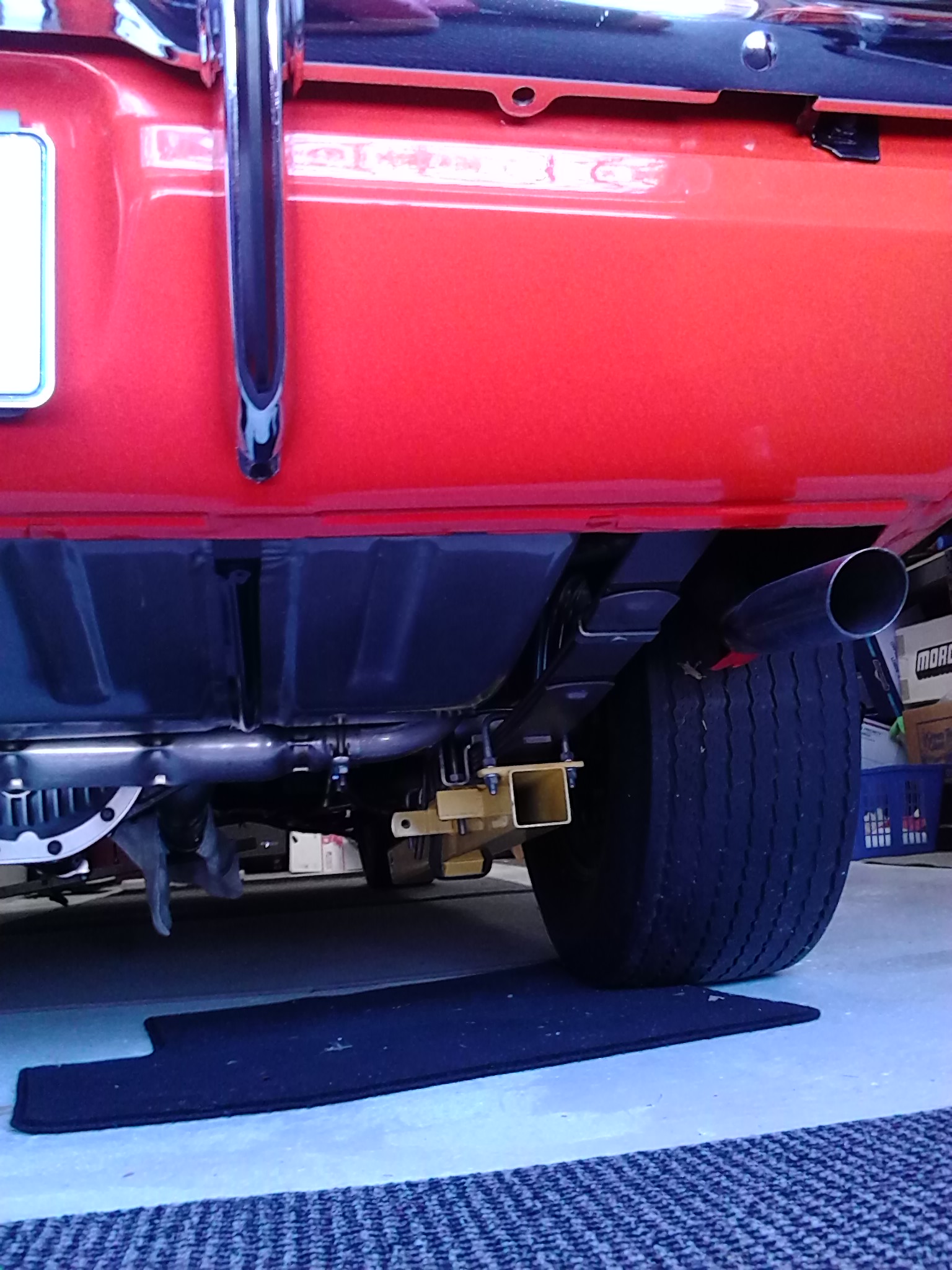

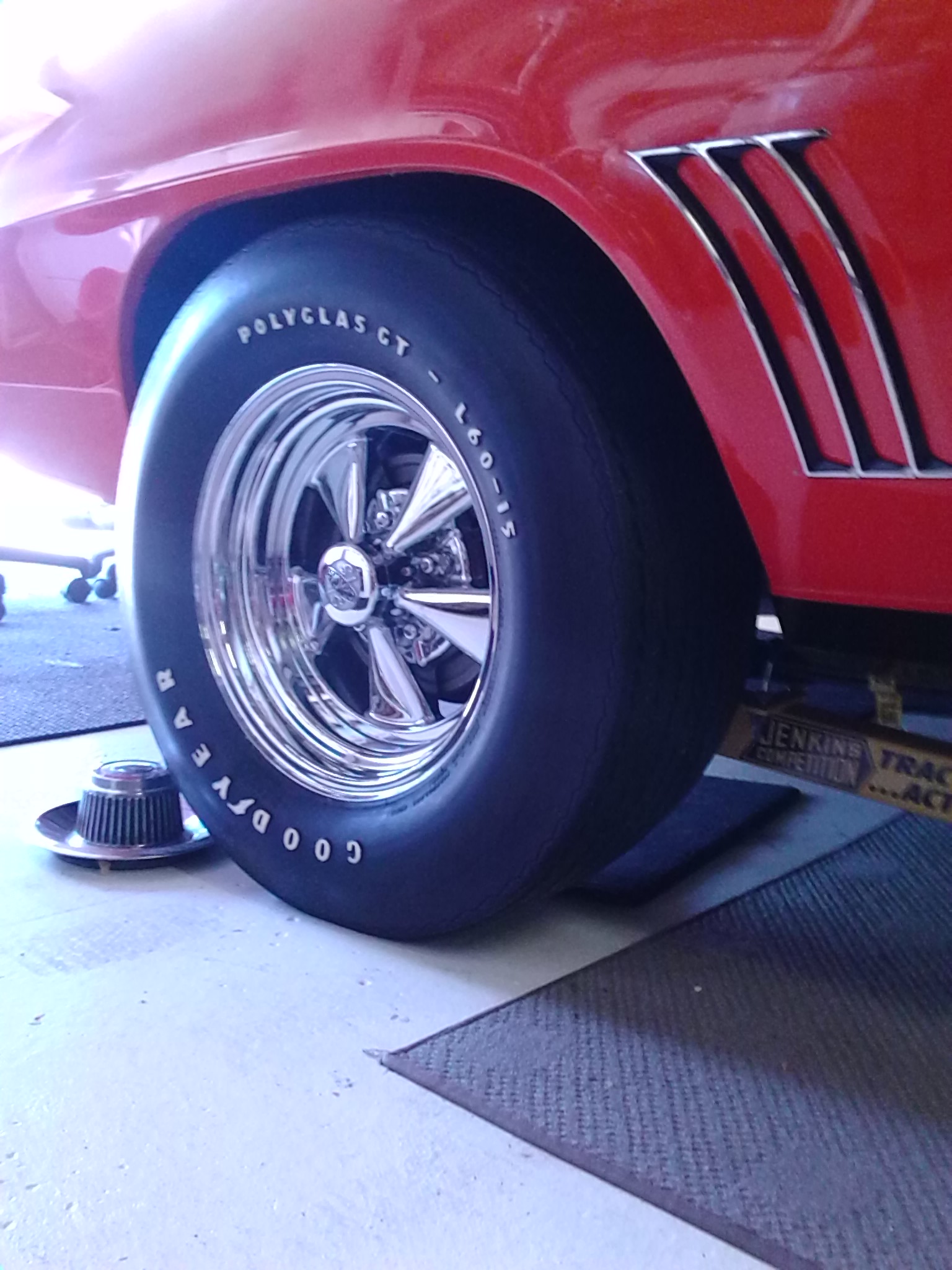

I have New Cragar S/S Direct fit 4 3/4.
8 1/2 &quot;x 15 &quot; with 4 1/2 &quot; back space.
L60 -15 GOODYEAR. Poly Glass GT
YES. 8 1/2 &quot; Width W/ 4 1/2&quot; B S.....
In Direct fit from. SUMMIT. Bought them 2 Summers ago.
5 inches of Back Space on a Stock suspension is preferred with L60 -15./ 275-60 , 15's. If You Have the ORIGINAL REAR SPRINGS ......THEY HAVE SETTLED ,,IF NOT FLATTENED OUT.....
CRAGAR OFFERS. A 5&quot; B.S. For Almost double the cost....
On the Front if you want a More Muscular Look
15 x6 /15x7 with 3. 1/4- 3 1/2 b.s. will kick the wheel out 1&quot; max....using F-G 60's . should clear
everything...
