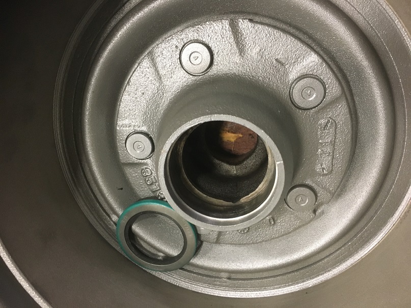

I media blasted the small brake parts I need to reuse. (Some parts are the same in the kit)
I started figuring out my from drums, I replaced one hub and drum and the seal is slightly different from side to side..... hard to explain and hard to post pictures.... I think I have a solution, other than the kid at NAPA staring blankly at me:-(

Ryan, based on the pictures of the 2 seals you posted on facebook I believe you do have different size's , If you can find a part number on the seal with a Flange I can verify it for you but I really think it is an SKF/C/R # 17815 it is flanged and a smaller 2.332"od (for 2.328" bore ) Let me know If I can help any further

Aaron: Everything you and Tweed sent me was exactly correct.
The one hub and drum I bought was a 1968 or early 1969 so I have the seal area turned the same as the 1969 hub so the same seal fits both sides.
I can sleep tonight:-) I was worried my car would drive in circles :-)

Ryan, Glad to help out and worst case you could have put that on the side that pulls the wheel off the ground from the Monster torque and you wold have been fine !! LOL ;0
Helps to Have a lathe !! Nice Work
