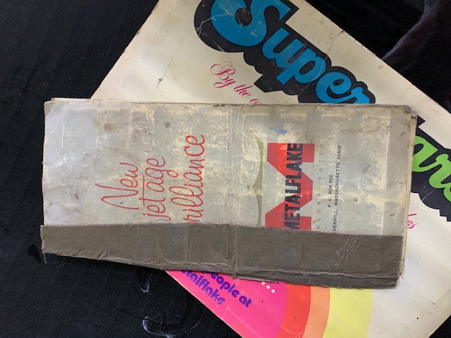

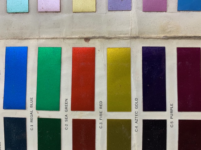

Back to topic.....Rick and I spent some time talking about the paint he used on Rat's Nest BITD. He was not able to locate any leftover paint in his shop like I discussed in an earlier post about the tail panel color. He did go to an old file cabinet and pull out this color card booklet by MetalFlake Corporation. He opened it up and showed me the exact paint colors used on the car. He said he painted the whole car with the white base, then did the entire car in silver mist pearl, taped off and sprayed the Iced Blue pearl, taped off and sprayed the Fire Red candy apple. All in lacquer, then topped with several coats of clear. We talked quite a bit about how all the photos show the silver as very "white". He said that Doug did not like how some of the white pearl paints had that goldish/tan cast to them so they went with the silver over a white base.
The Rat's Nest name was hand-applied by Tom Blackstone "Stoney" (deceased). The letters were gold leaf with a white outline.

That is awesome to be able to gather all the paint info direct from the original painter, and even more credit to him for having such a great memory!

Those metal flake paints are the same ones they used on my car, pretty cool to see the swatches, thanks.

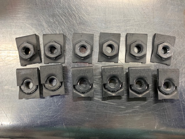

cleaned up my original cage nuts that mount to the inner fenders. Interesting that 3 of the 12 were a slightly different style with a part number stamped on them. Went to work on my door latches - before/after pics that show original LB paint residue.

Interesting, those are not the J-clips that I normally expect. Most of the time, 69 NOR used square nuts, not hex nuts.

by the way - a short stent in evaporust helps with the orig finish come thru beautifully

I obviously can't guarantee they're original to the car.....I wonder if it's a late model year thing? Maybe some other owners of "last 3 month" cars will chime in.

These are the ones in Nuge’s 69 copo. 09E if I’m not mistaken.

Thanks Darrell, yes Nuge's COPO is 09E. It may not make a difference but the j nuts I posted were attached to the inner fender where it bolts to the wheel opening of the fender.
