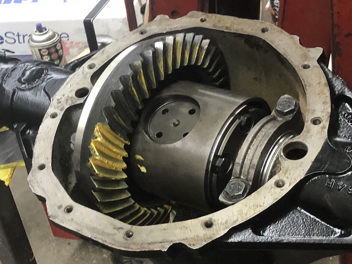

Oh yeah...almost forgot. The diff is ready now too! Powder coated the housing, new axles, new Timken bearings and seals, new install kit, Eaton TruTrac carrier, and setup a nice pattern on the old GM ring and pinion. Buttoned up the cover late this afternoon and just need to add some fluid before I put the brakes on it.
Big thanks to Freddie for some real sound advice along the way.

I'm glad to help. I hate to see people spend good money on parts that aren't good.
