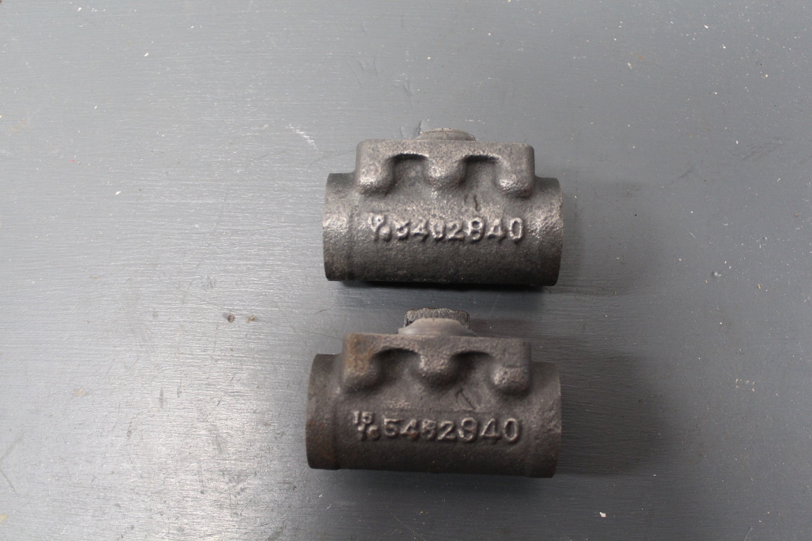

Heard from another 69 SS396 owner and states the same as you Sam, 15/16".

I'll confirm what Sam has said about the wheel cylinders. I pulled these original cylinders from my '69 Chevelle, KK 4.10 axle and they are 15/16.

Maybe that 3/16" rear brake hose is somewhat standard too. I just have not laid hands on enough 69's to know.

My June built Baltimore 69 SS vert had the 940 15/16 rear brake cylinders and the 3/16 inch rear brake line
