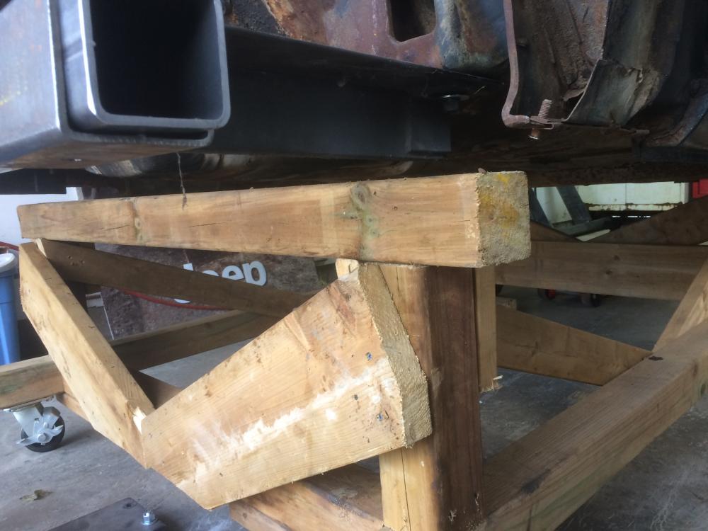

I am a stereotypical Tim Hortons junkie.
Dan, we cut 2 X 4's to place the front clip on:-)

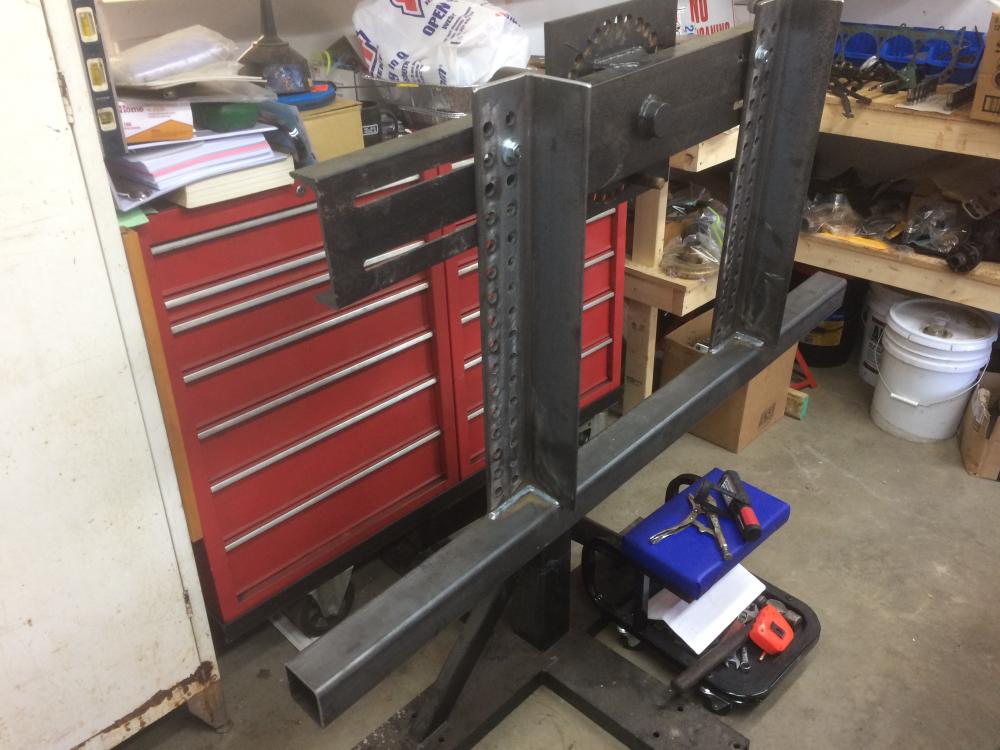

Old 03-04-2017, 01:22 AM
Ryan1969Chevelle's Avatar
Join Date: Nov 2012
Posts: 6,003
Thanks: 636
Thanked 980 Times in 486 Posts

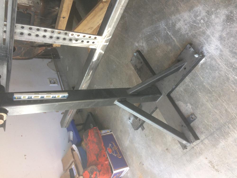

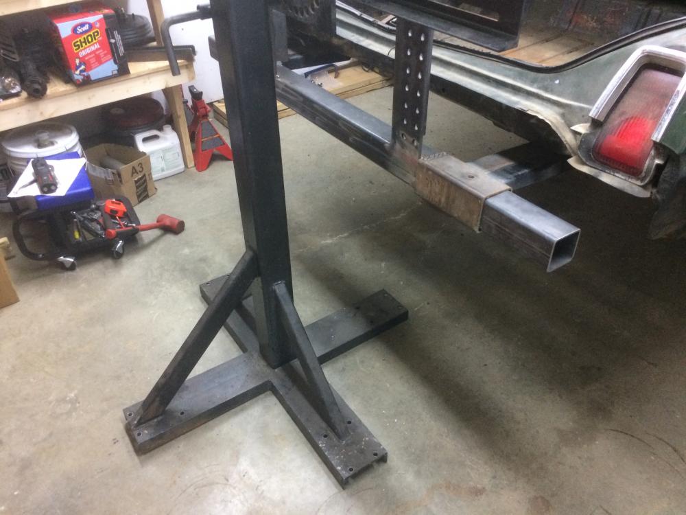

Closer to spinning:-)
Made brackets.
Ryan

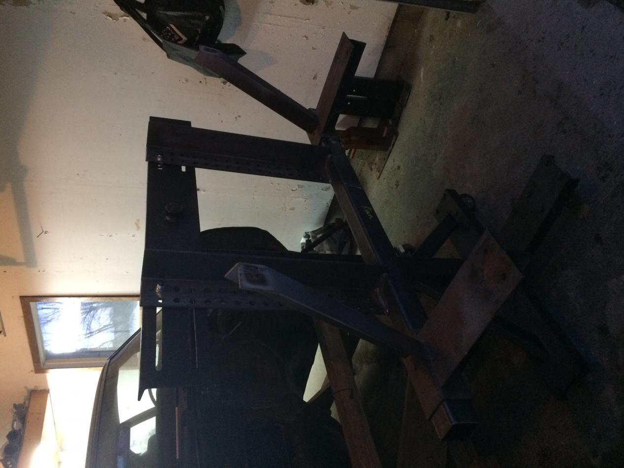

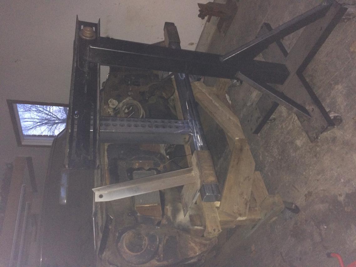

Old 03-12-2017, 11:40 PM
Join Date: Nov 2012
Posts: 6,003
Thanks: 636

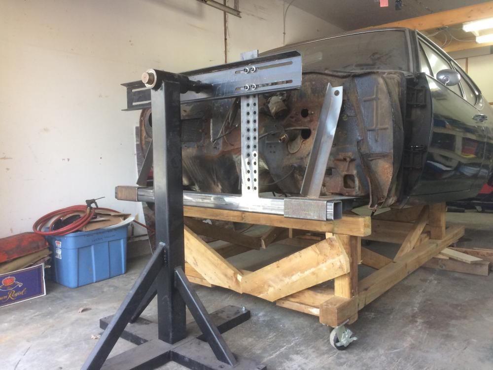

The front half is in the air:-)
The back half is close, but I need to fix the two furthest back body mount caged nuts.
Progress:-)
Ryan

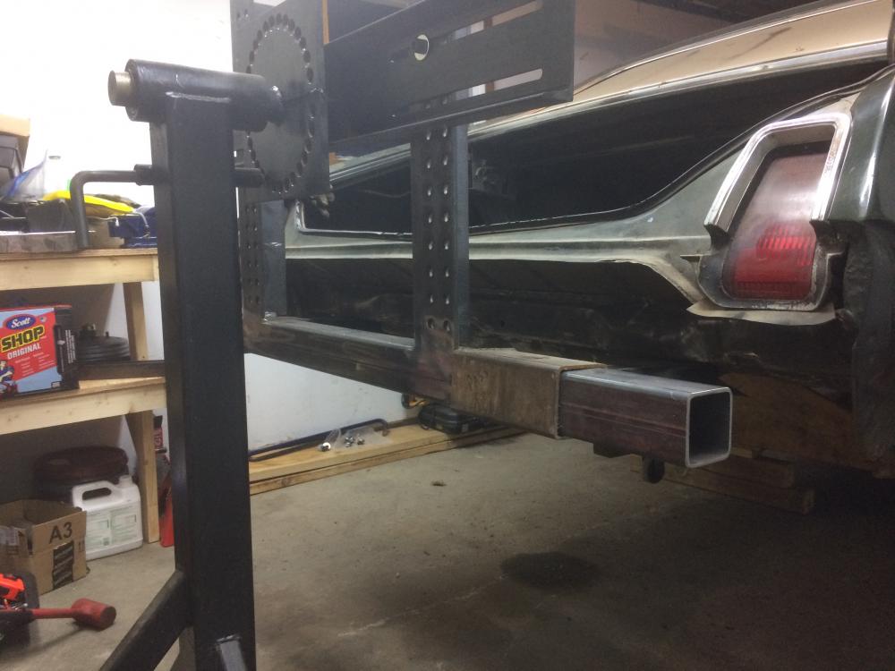

I test fit the rear half of the rotisserie, I need to adjust one hole placement 69, vs 70 Cutlass must be different? Also need to nip off 1/2 inch from the 3.5 inch square tubes so I can adjust them side to side a wee bit.
Then I need to get the cart out and test the center of gravity. By the hundreds of pictures on the internet I should be about 6 inches low..... TBD.
Ryan
