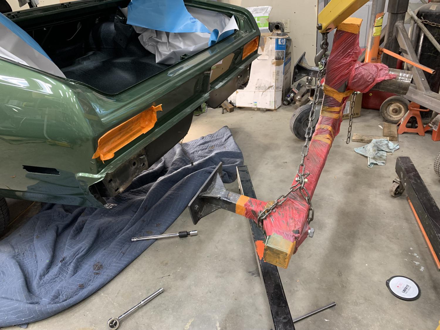

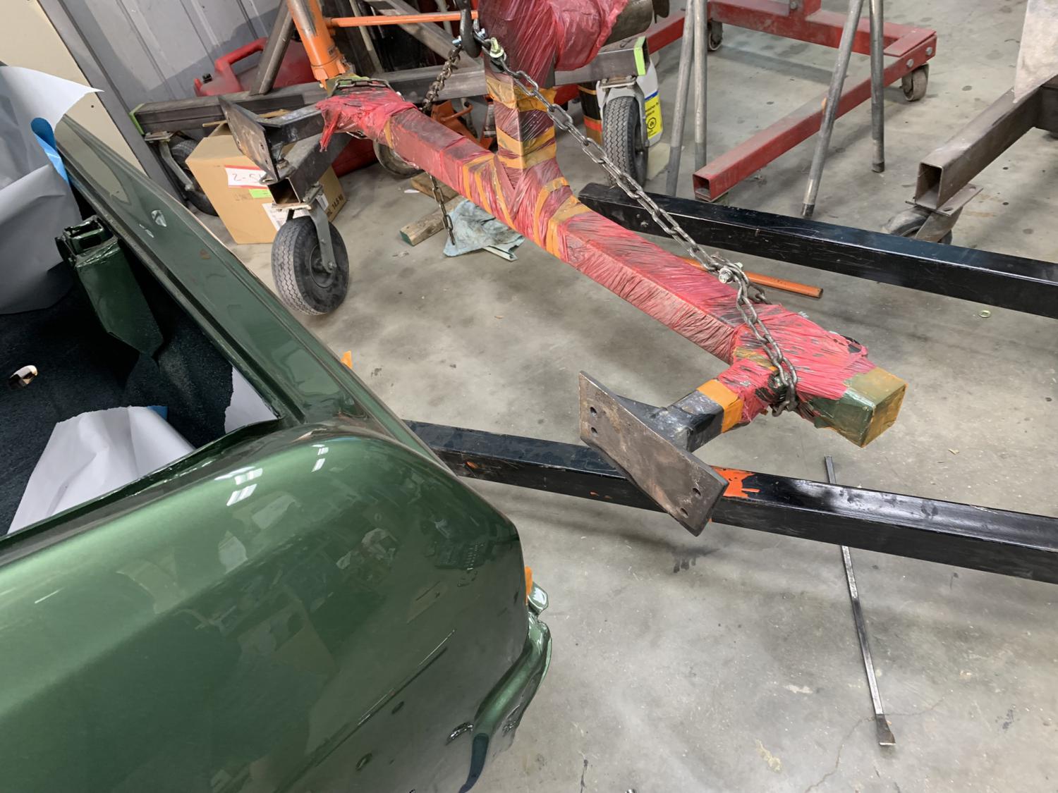

First up, get the engine crane to lift the back off the rotisserie. You can see the front frame horns are on huge jackstands so I will need to do this in steps.
Set the back down onto riser blocks.
Remove the framework.

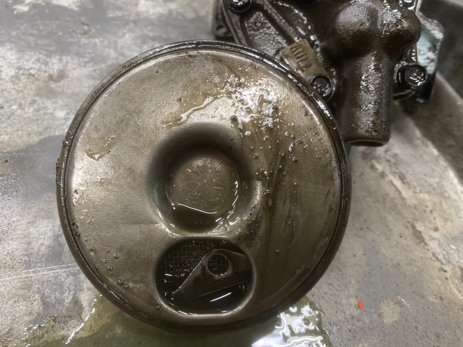

A valve cover load spreader is peeking out from the oil pick-up screen. He was in there with two friends. THREE valve cover load spreaders and a medium handful of orange silicone sealant chunks YIPES ! I still have a hard time believing this thing survived.
