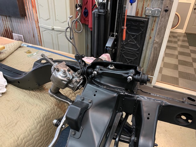

Well, got the front subframe pretty much completed today. Let me know if you see anything wrong, now's the time to fix it. Most everything you see is original to the car including brake lines/clips, all steering components, 2 pc. rotors. Ball joints, and bushings replaced with OE quality stuff. Brake calipers are originals and dated correct, just not original to this car. Natural metal stuff is all cleaned and coated in Baoshield.

I don't know enough about it to know if it's correct or not, but it sure looks good!

I agree with BGH, not a purist but looks good. Especially with mostly original stuff.

Can't tell, but if you didn't "blue" your draglink: Brownells Oxpho-blue. Very simple to do, a little goes a long way, and adds a nice touch to welds on driveshaft.
I also thought it brought back a nice raw cast finish to the yokes, opinions probably vary on that.
I believe engine frame mounts more of a gloss, double check, I'm at work, notes at home.
Very enjoyable thread.

Yenko member Edgemontvillage is doing one of the most definitive restorations on a '69 Camaro ever, over on Team Camaro - this is page 23 where he gets into the blue-ing process for drag-links. Following anything he is doing is a good call for your resto.

Thanks for the comments guys. I actually had the engine stands painted a 60% gloss originally and thought they looked too shiny so I re-painted them. Maybe they should be closer to 45% instead of 30% like the subframe?
I've seen Loyd's thread and you are correct, that is an "over the top" resto! I'm not saying the drag link shouldn't be that dark gray finish, I'm just wondering then should the outer tie rod pcs. that hook to them also be that way? I'm assuming same supplier would have used the same process on all those parts?
