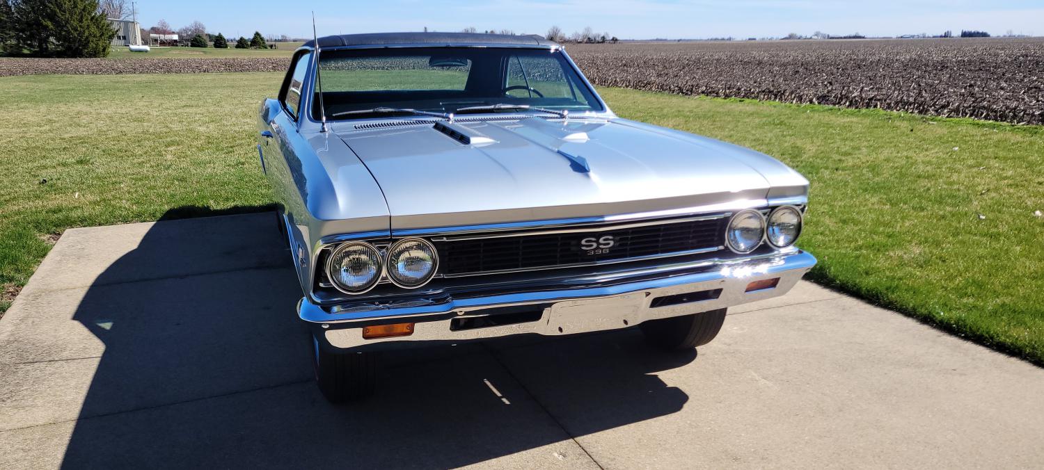

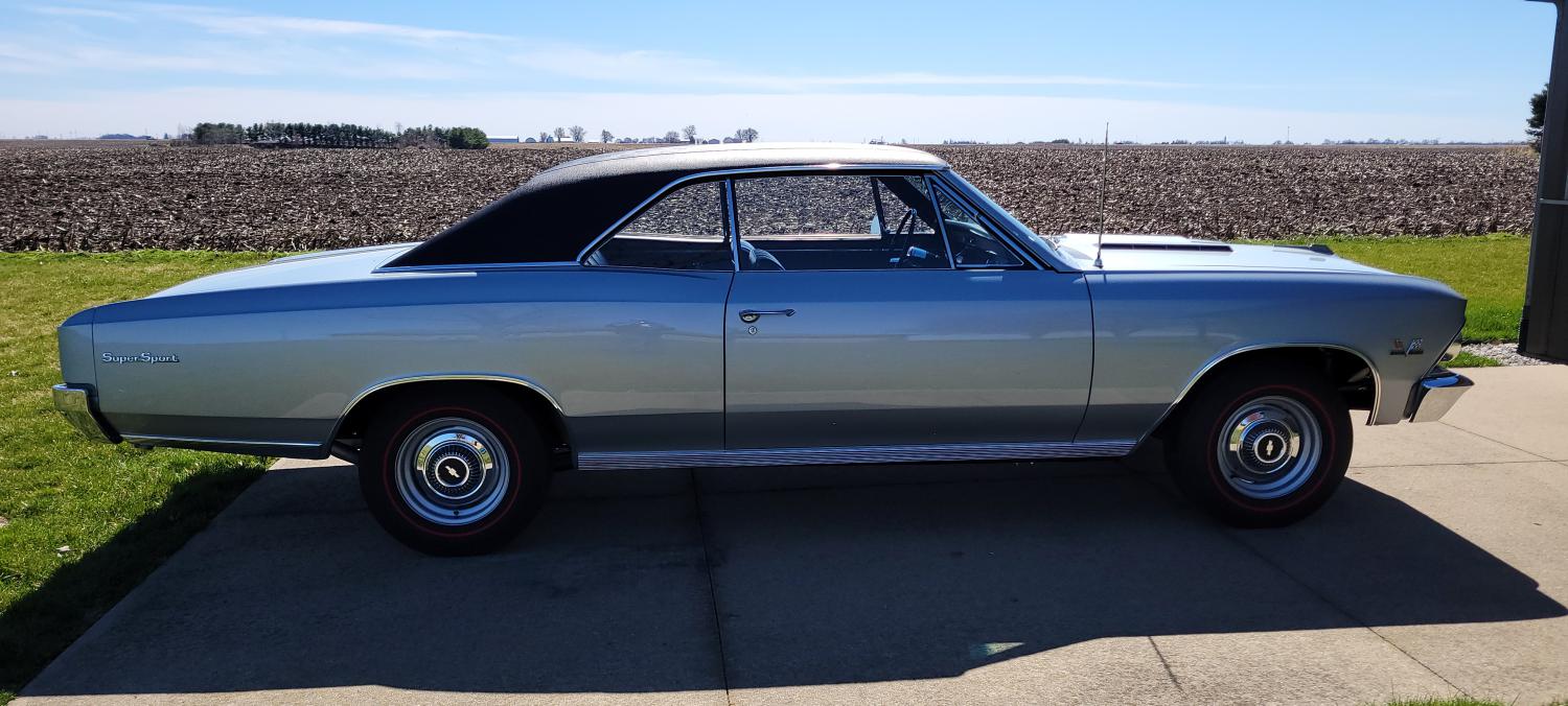

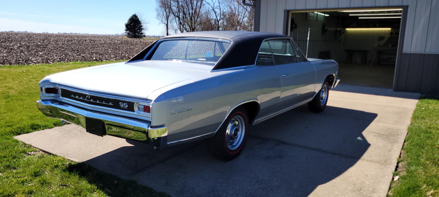

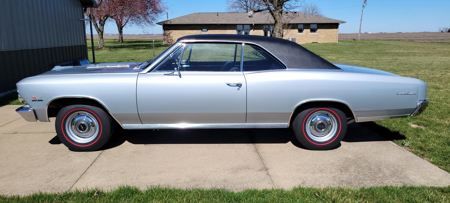

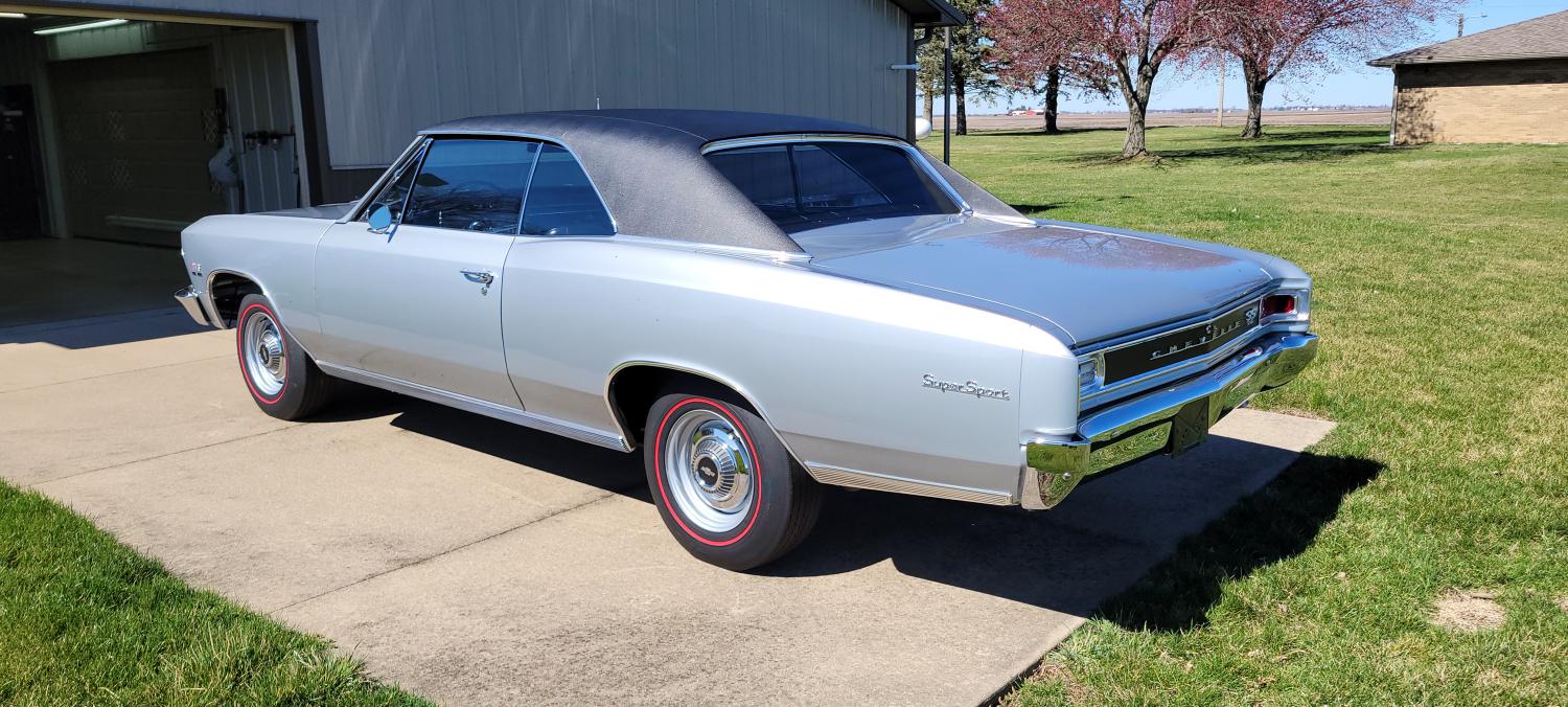

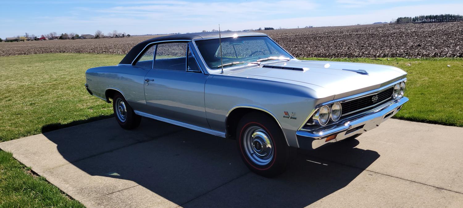

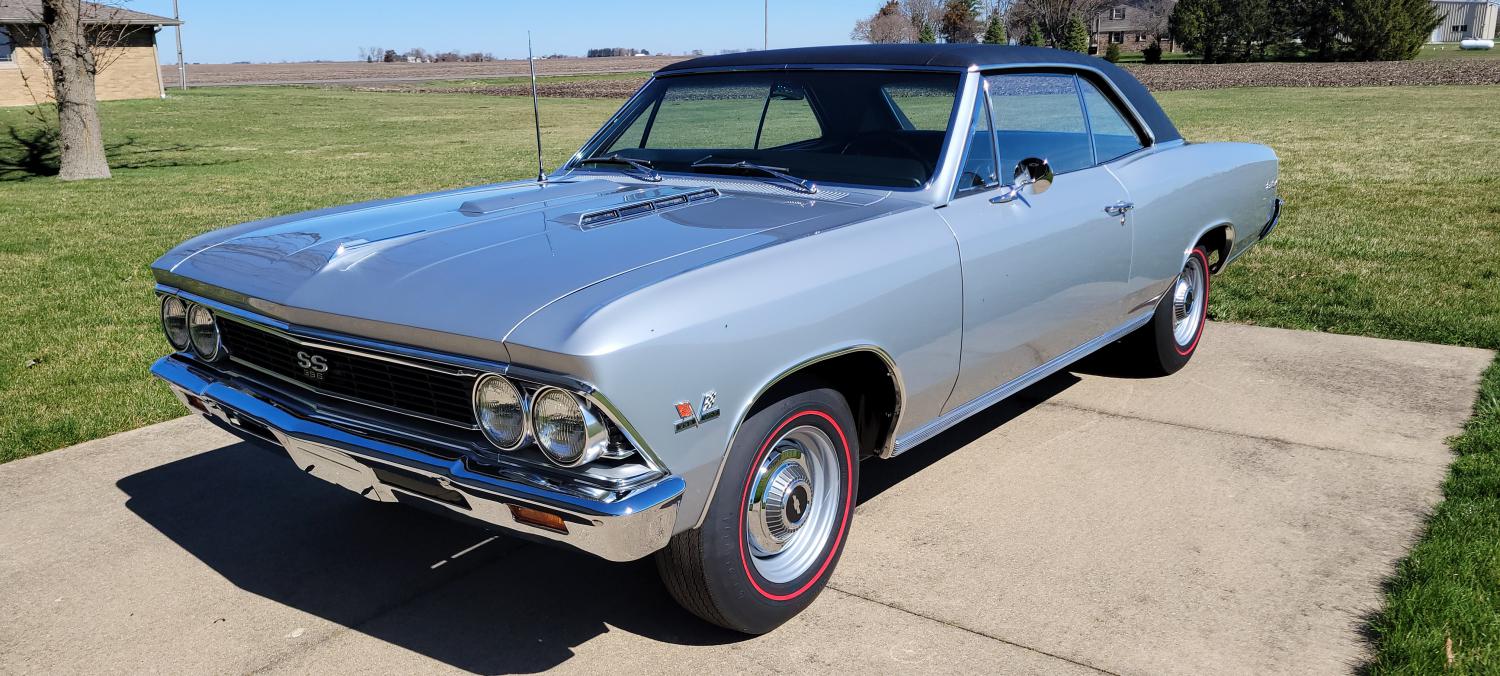

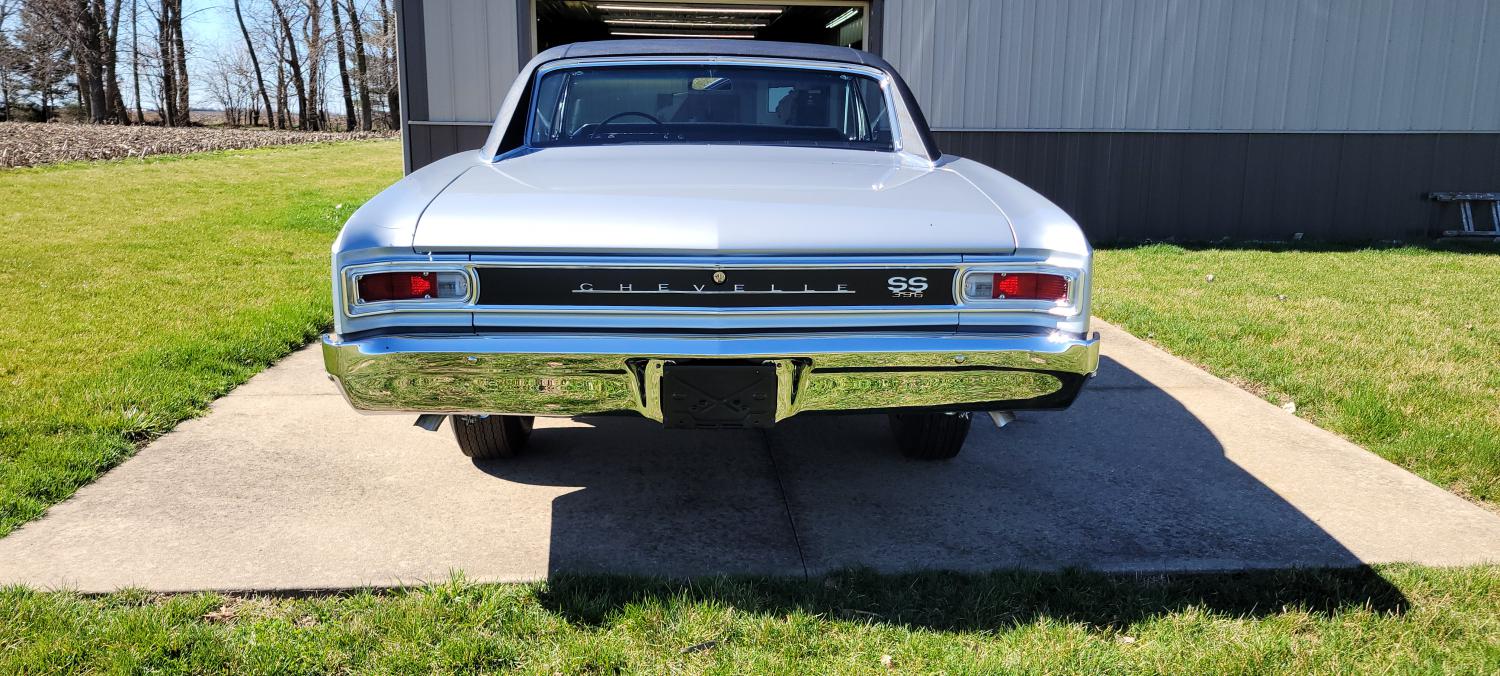

Default Restoration Complete
I think it came out ok.

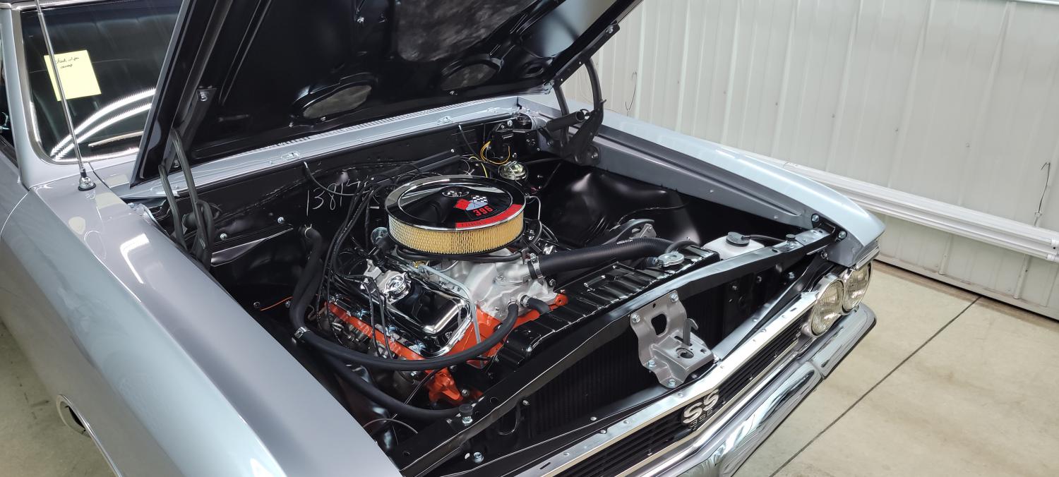

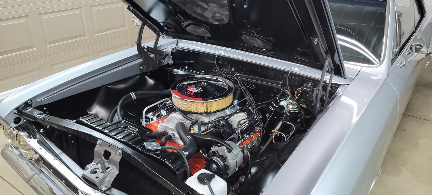

Well that is an understatement! Looks GREAT! Some under hood and interior shots pleez!
Sam...

Im a pretty hard critic of my own work, but thankyou.

Gorgeous! Best color for ‘66.

Beautiful Chevelle! You do great work.

Absolutely amazing job!

Not typically a fan of the vinyl tops but your car just flat nailed it. Always impressed when someone starts with a car in the condition most people wouldn’t touch and turns it into a masterpiece like you did Sir. Great job and Thanks for saving it!
