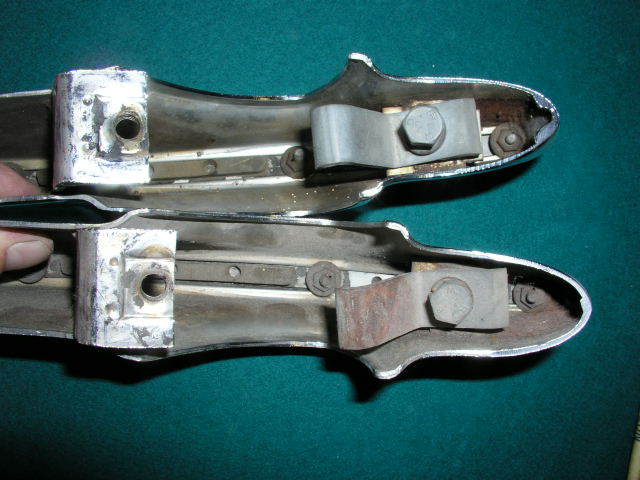

Those rubber cushions fit 1967-68-69 Camaro Front guards.

Uh oh......Scuncio......
  #13
Old 09-12-2008, 06:31 AM
Location: Woodland, ca. US
Posts: 16,127
Thanks: 562
Thanked 5,473 Times in 1,327 Posts
Default Re: 1968 Camaro Rear Bumper Guards
I just held them up and they looked right.

I think that PN fits both 67-9 front and also 67-8 rear...hopefully?!

1967-68 Camaro Fronts were #3893801-LH & 802-RH & used cushion #3893800.
1967-68 Camaro Rears were both #3891694 & used cushion #3891697.
1969 Camaro Fronts were #3938681-LH & 682-RH & used cushion #3893800.
Together complete they were sold as Accessory #993506.
1969 Camaro Rears were both #3938607 & used cushion #3938611.
Together complete they were sold as Accessory #993510.

I have more cushions. I will look next week for 3891697 or take one out and see if it fits.

Rick, I searched around and the reproduction rubber inserts evidently combined the 3891697 and 3893800 applications into one part number (see link below). Now I am curious about the differences....

Good question..I don't know if the reproduction house lumped em both together incorrectly or not.They have in the past when a part is close enough in design to another.
All the books,since their inception to as late as 1995 show those two cushion numbers as seperate applications.

1967-68's also sold as a complete Accessory kit too.
#986805 folr Rear & #986806 for Front.
There's some 67-68 rear guards & NOS rear #1697 cushions too on eBay if you scroll down..
