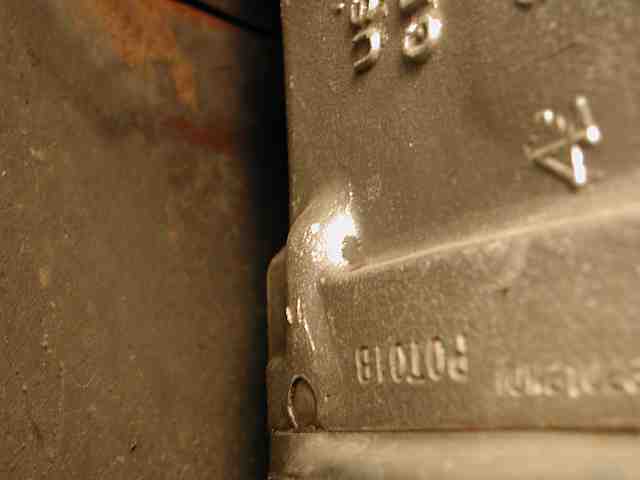

Ok, I know I am open to all kinds of opinions both good and bad. However, it seems to me that this site has more experts than any other site. I am about to finish a rotisserie restoration on my 1970 L78 Nova SS. The car has the vin on the engine and transmission. However, I have not been able to obtain any other documentation. In my limited experience, the stampings and broach marks look legitimate. Please way in on what your belief is as I will be putting the car on eBay in a few weeks and need to get the opinions out now and not while it is on eBay. I am not a dealer but a (58) years young Warden of a Correctional Facility here in Maine and I love all types of Muscle cars.

Vin. Number Decode 114270W192535
1 Chevrolet
14 Nova 8-Cyl
27 2-Door Sport Coupe
0 1970
W Willow Run Michigan
192535 Sequential Number
Body Tag Decode
STYLE 70-11427
BODY WRN111198
PAINT 28 28
TRIM 733
11D A
STYLE 70 1970
11427 2 Door Sport Coupe Nova 8-Cyl
BODY WRN Willow Run, Mi.
111198 Sequential Body Number
TRIM 733 Black Vinyl Bucket Seats
PAINT 28 Fathom Blue Lower Paint
28 Fathom Blue Upper Paint
11D 11 November
D 4th Week of November
A Accessory Code
Block Casting Number 3969854 1970 402/375hp 4-Bolt Correct
Block Casting Date J30 9 Correct Time Frames
J October
30 30th Day of October
9 1969
Block Stamping Numbers T1121CKO 10W192535 Correct
T Tonawanda Engine Plant
11 November
21 21st Day of November Correct Time Frames
CKO 402/375hp Special High Performance 4-Speed
1 Chevrolet
0 1970
192535 Matching Vin Number
Heads 3964291 1970 402/375 Correct
Pass K3 9 Correct Time Frames
K November
3 3rd Day of November
9 1969
Driv I11 9 Correct Time Frames
I September
11 11th Day of September
9 1969
Crankshaft 3904815 1970 402 Nodular Iron Correct
Crank Pulley 3937787 Correct
Flywheel 3789733 396/427 Big Block Correct
K18 9 Correct Time Frames
K November
18 18th Day of November
9 1969
Carb (Reconditioned) List #: 4557 1970 402/375hp Nova Correct
Part #: 3967477 GG Correct
Model #: 4150 Correct
9A1 Correct Time Frames
9 1969
A November
1 1st Week of November
Intake Manifold 3963569 1970 402/375hp Nova Correct
11 3 69 Correct Time Frames
11 November
69 1969
Exhaust Manifolds LH 3909879 1970 402/375hp Nova Correct
K5 9 Correct Time Frames
K November
5 5th Day of November
9 1969
RH 3916178 1970 402/375hp Nova Correct
K4 9 Correct Time Frames
K November
4 4th Day of November
9 1969
Water Pump (Reconditioned) 3969811 1970 402/375hp Nova Correct
K6 9
K November
6 6th Day of November
9 1969
Alternator (Reconditioned) 1100837 1970 402/375hp Nova Correct
9K21 Correct Time Frames
9 1969
K November
Starter (Reconditioned) 1108418 1970 402/375hp Nova Correct
9J5 Correct Time Frames
9 1969
J September
5 5th Day of September
Distributor 1112000 1970 402/375hp Nova Correct
9H20 Correct Time Frames
9 1969
H August
20 20th day of August
Transmission Numbers P0S13A-0W192535
P Muncie 4-Speed Wide Ratio Passenger
0 1970 Correct Time Frames
S November
13 13th Day of November
A M20 Close Ratio. 2.52/1.88/1.46/1.00/3.11
0W192535 Matching Vin Number
Transmission Casting Numbers
Main Case: 3925661 1970 – 1974 Muncie Correct
Extension Housing: 3857584 Correct
Side cover: 3952648 Correct
Rear Axle 3969341 1970 12-Bolt Rear Axle Correct
CBT1103G
E
CBT 1970 Nova 3:55 Posi
11 November Correct Time Frames
03 3rd Day of November
G Detroit Gear & Axle
E Eaton Positraction Differential
Bell housing 3899621 Correct
Thermostat Housing 3877660 Correct
Harrison Big Block Heater Core Date 69F Correct
69 1969 Correct Time Frames
F June of 1969
Jack Assembly U69 1969 Correct
