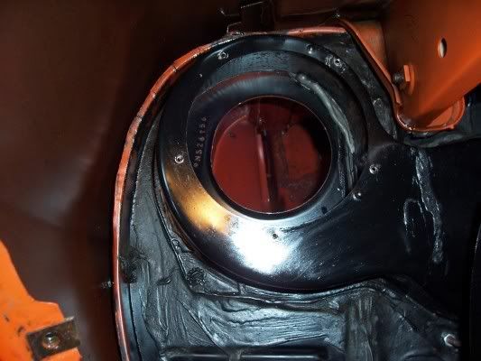

The first picture below shows the DATE of mfg, plant location & shift on 70 Camaro subframe.
2nd and third pics show Jack Seymours Unrestored, Unmolested, Original 70 Z-28 hidden VIN stamping.
LOOK on inside firewall area with Blower Motor removed
Links are only two of MANY at www.nastyz28.com. If you were too search (VIN number stamp or sub frame VIN) at the most informative 2nd gen Camaro web site, you could read volumn's on this subject
In conclusion there are NO other complete VIN numbers stamped on body or frame other than under fan plenum on firewall.
If you have evidence showing otherwise, the 2nd Gen LEGENDS judges at the American Camaro Assoc "Camaros at Carlisle" this June 20-22, would welcome the education!!!!!!!

The 2nd Gen enthusiasts at www.nastyz28.com have never seen evidence of any other body/frame VIN stamping.
That's not true. I recall seeing posts about the subframe VIN on NastyZ28.com. I then looked at my subframe to see if I could find one and I did. Unless I was dreaming it. I'll take a look when I get home.
Chuck you are 100% correct. That was the picture and thread I was thinking of. My apologies.. Here is mine somewhat faint at the beginning of the stamp.
3 - March
10 - Day
70 - Year
N - Are we certain that's Norwood? My car is LA...
