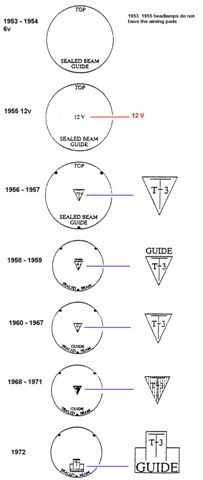

Default T-3 Headlights / High Beams
I have a few of these in my garage. What year and model did they originally come off of? Also is it true the high beams have 3 prongs and the regular headlights have 2?
Thanks in advance,
-Dave
