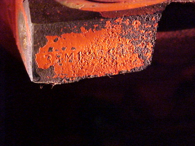

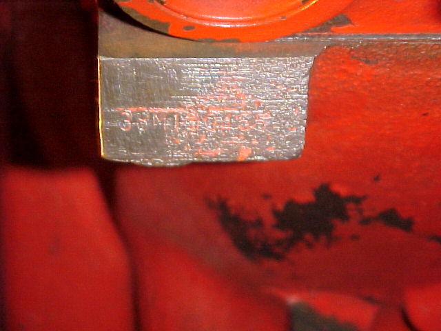

..1st engine ID photo

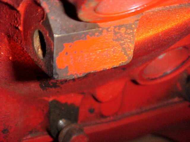

..2nd engine ID photo

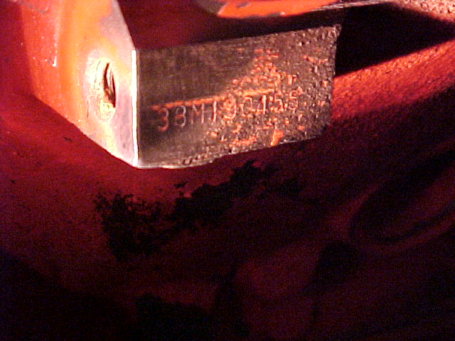

..3rd engine ID photo

..4th engine ID photo

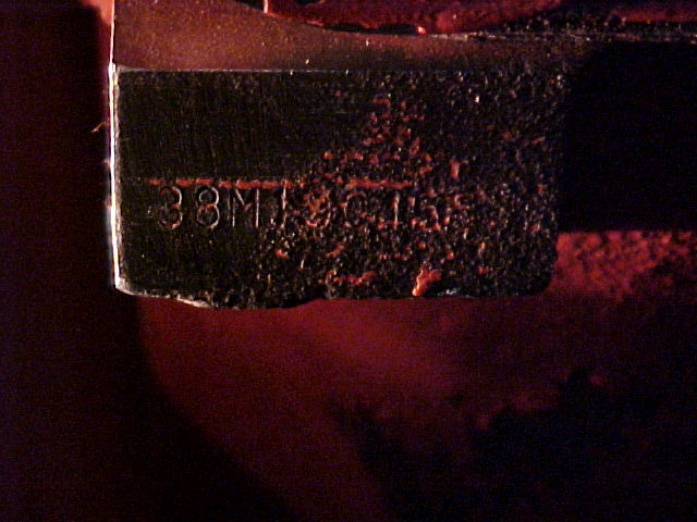

...best photo of engine ID

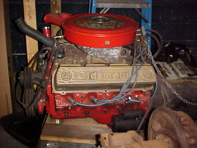

...engine photo ..no flash

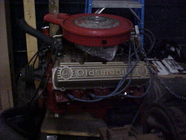

..engine photo with flash

..hope this helps
...sorry for all the photos of the same area..
..but my eyes aren't as good as they used to be

38M190455 decodes to
3 - Olds
8 - 1968
M - Lansing
190455 - 190455th car down the line
The valve covers are GM Performance Parts units and retail for $300 a set new last time I checked.
Beyond that you'll have to open it up to see what you have. That looks like the big car (88/98) air cleaner, so assuming it started life on this motor I'd expect small valves, unless someone has upgraded them.
