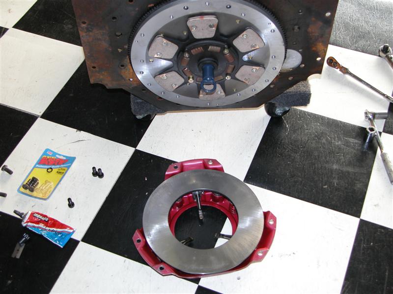

Here is the clutch I'm going with now. It is a Ram adj. Press. Plate
with a 6 paddle SPRUNG disc, Mcleod Hyd T.O.B. &amp; an alum. flywheel. </font>

WOW!! This tranny sounds pretty intense .
And your clutch set up Looks very nice . What brand of trans are using?
