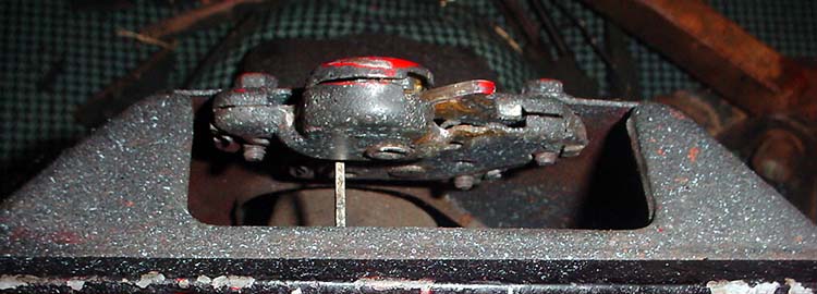

Paint...and the custom color matched locking mechanism for the rear deck lid!
Actually all 68-69 Camaros have body color painted strikers on the decklid and the latch portion bolted to the tailpanel support. They were already bolted in place before the car was painted. The same goes for the door latches and strikers, all were painted in 68-69. Now the 67's had the latches and strikers bolted in after the cars were painted but sometime during the year they changed that procedure. I am not completely up to date on the time frame of each plant but late 67's had painted latches in the doors and the trunk. I know the trunk latch and strikers were already being painted body color sometime around late Feb or early March of 67 for the Norwood cars, maybe earlier. Not sure on the doors though, maybe Jon M. can shed some light on this subject.................RatPack..................
