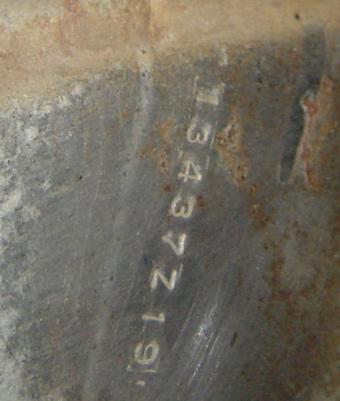

  #15
Old 06-27-2005, 03:12 AM
13667 13667 is offline
Join Date: Jun 2005
Location: NC
Posts: 12
Default Re: 70 SS Body Tag, Vin Plate, Firewall Stamp Question
Here is a photo of the stamped number that was found inside the car, on the interior side of the firewall, under the blower motor and inside of the duct area on the passenger side. (hope that makes sense) It reads 13437Z19.

  #17
Old 06-27-2005, 05:37 AM
ohhawk ohhawk is offline
Join Date: Jun 2003
Location: Iowa
Posts: 434
Thanks: 5
Thanked 70 Times in 21 Posts
My opinion (may not be the correct one) is that the number you have found inside the heater duct area is not a # that should match up with your body style #. I don't know what that # is (13437Z19) but it looks an awful lot like the same type of # SS427 was referring to that some cars have stampled on the body near the gas tank filler recess. I have seen some of these #'s and they also look much like the number you have listed in the heater duct area on your car.....same number of digits with a letter included. Maybe Rick / Minneapolis can chime in on what his research has shown him about the numbers stamped on the body near the gas tank filler recess.
I don't believe that the fact that the # you have found in the heater duct area does not match the body serial # for this year/model is any indication that the car is not what it has been touted to be.
