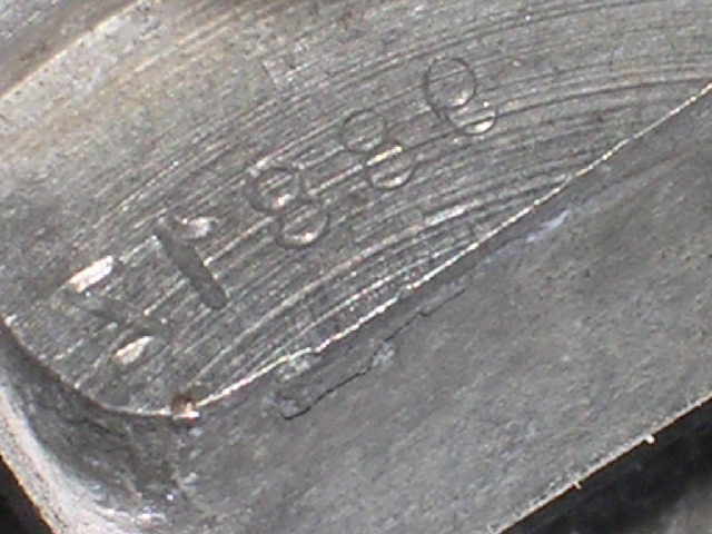

  #15
Old 04-25-2005, 07:39 AM
budnate's Avatar
budnate budnate is offline
Join Date: Feb 2003
Location: Bothell, Wa.
Posts: 4,076
Thanked 2 Times in 2 Posts
Default Re: '69 L78 'Velle Smog ID
something like this....

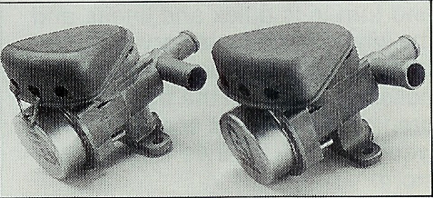

  #16
Old 04-25-2005, 09:10 AM
JoeG JoeG is offline
Join Date: Mar 2003
Location: Brooklyn, N.Y.
Posts: 3,265
Thanked 6 Times in 5 Posts
This might help--the diverter valve on the left is NOS, the one on the right is Memmorex(ASL)--Nice copy.
The original pump pulley also had a very deep"V" groove.Just some info.....correction for above--#2,#8,#7cylinders
Can you break down those numbers into English Bud?.....
  #17
Old 04-25-2005, 08:00 PM
budnate's Avatar
Join Date: Feb 2003
Posts: 4,076
I was trying to learn about smog stuff but had very little luck coming up with much info the guys that know it are not openly sharing...what I gathered is the one I posted is what they refer to as a "Julian date" I think it reads as 98th day of 8 meaning 68 and I cant find me meager notes at the moment the 1 and the Z are where it was made and application or something close to that..hopefully Rick will give us a lesson on the subject.
