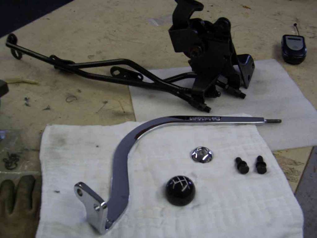

Therefore folks the GM assembly manual also lists
Note (2) 3973864 for m20 m21 m22 W/bucket seats. and if that
is correct then the 864 handle is the bench seat handle and the bucket seat with no council ?. Is the assembly manual wrong or have people installed the wrong shifters in their cars?
see the attachment of the infamous 864.

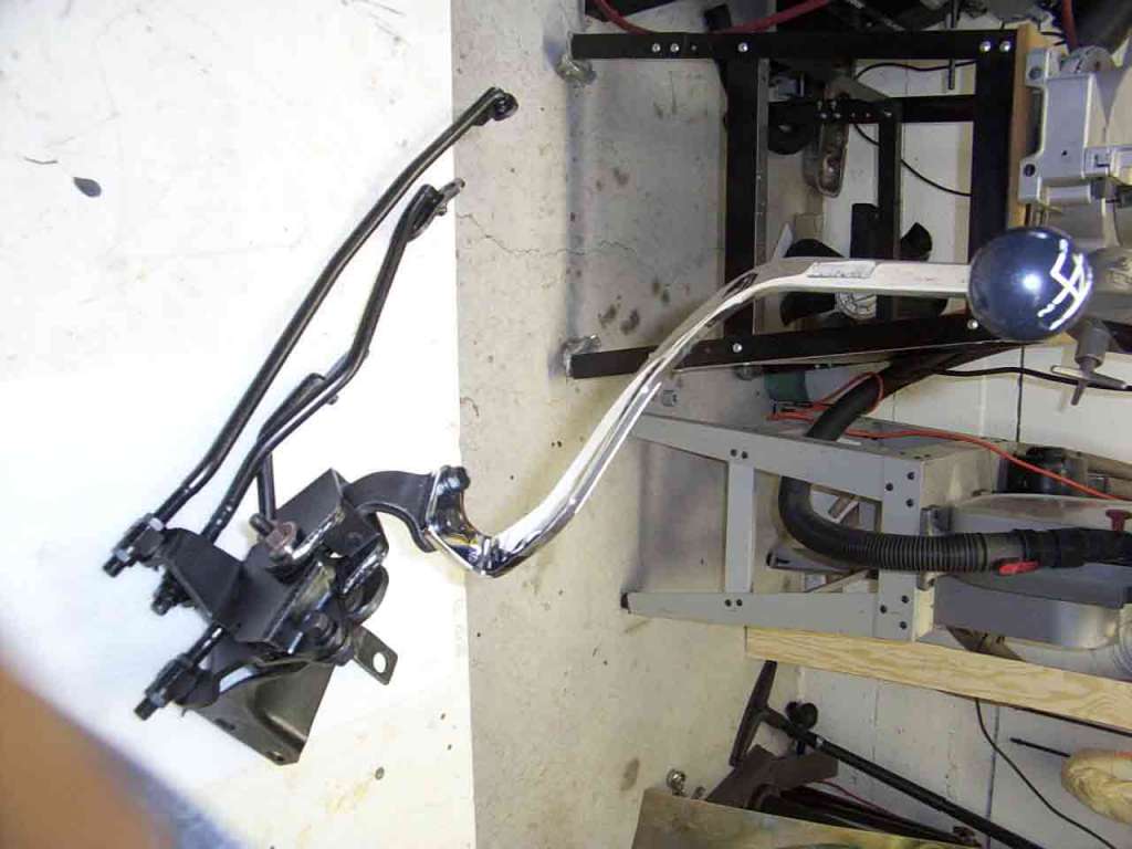

another view

Peter
Go to this auction on e bay and look at this shifter handle,look really close and you will see th eoffset that I was refering to! A non counsole shifter and a bench shifter handle do not have that offset.That offset was just for console cars,it had to have that offset to come up through the shifter hole in the center.That off set is the reason for the 3 part numbers!
Bobby dodson

Thanks Bobby
At this point I think that you might be right. However without the evidence and part number we cant be sure.
Other members also expresed the same opinion. The council shifter is definately bent so that it clears the council as it comes out of the council It would be reasonalbe to presume that there is no reason for that bend to be
used on a bucket seat car or bench seat car. I am going to keep digging. My friend who has a 70
chevelle ls6 is right when he says that in order to find
the exact shifter handle part number used is to find the GM manual printed in 1969 for the 70 chevelle.The first editon. The later books cant be relied upon.
