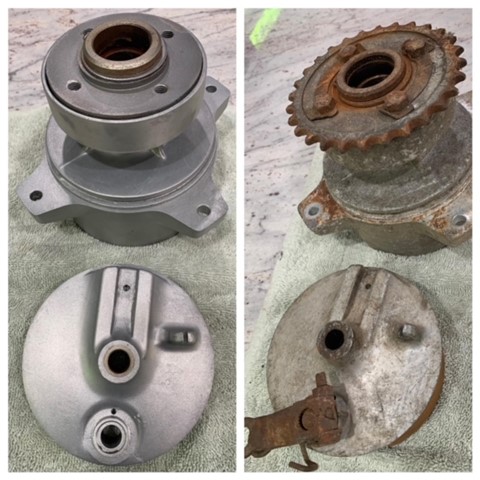

Here's a part off my mini-bike that I'm restoring that I had vapor-honed. Works really well on aluminum parts.

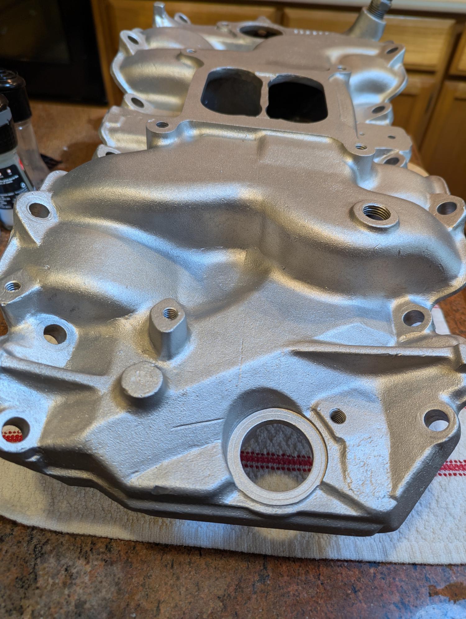

This Aluminum Intake was METAL Shot Blasted in a machine that is only
used for Clean Alum Parts so as to not contaminate the metal shot

3963569 LS6/L78 Intake that I ran thru Metal Shot Blaster.................
