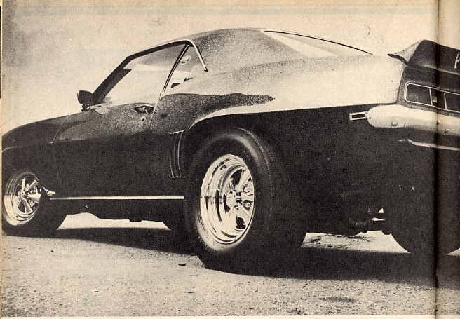

Here are the specs for this pic L-60-15 rear (275-60-15) on 15x8 wheels, article mentioned the rear size but not the front. Looks like 15x6 on F-70. I know the rear size is correct per the article because in the pic I can see the L-60-15 on the sidewall (7:00 position). I have small pic from the front and the tires are definetly not 60 series.
Also he is running air shocks. I back from my original position. You may need to run air shocks, small shackles or rearched springs to get the car up in the rear to clear the tires. However, this car definetly has the right stance and look.

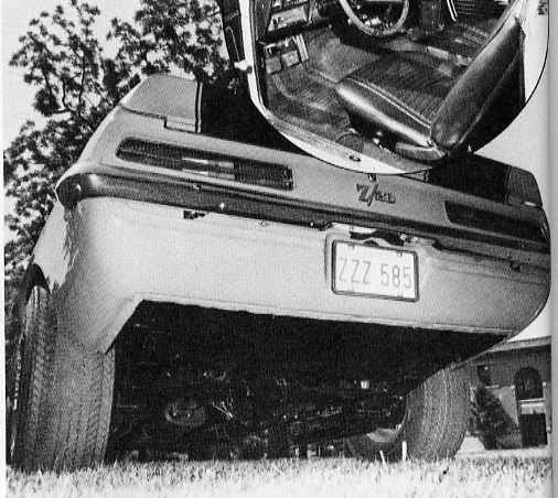

Another 69. 275-60 rear on 15x8, 15x6 front on F-70-15.
You can see the 70 series on the front sidewall. I personally don't like the M/T F-70 tires. They are too wide and have a funkly look. Best is Goodyear or Firestone F-70. Car has a nice rake.

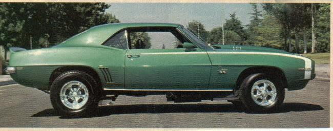

Rear shot

The right way a Camaro should sit. Raised front and rear with a nice rake. But this is my opinion. Can't handle tail draggers.
