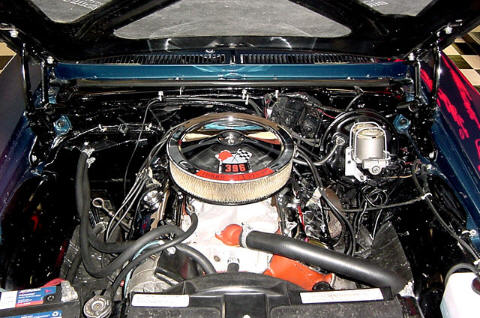

Ron,
Here's a pic of a 1970 L78 SS that I found on the net. It's supposed to be an all #'s matching car. I don't know much about it but was talking to a guy at a car show and he said he used the same mounts when he swapped a BB into his SB Nova. I always thought you were supposed to change them.
Richard

Richard,
It looks to me like he used a smaller brake booster and the master cylinder is not correct. That would make sense as to the brake system changes. Anybody else think the booster is smaller?
Is the car you posted the one that was switched? The brake stuff isn't original. I really haven't "eyed" it other than the brake stuff.
Ron [img]/ubbthreads/images/graemlins/flag.gif[/img]

As I understand it, the purpose of the different motor mounts for the big block was the provide some exhaust clearance around the steering box. The mounts shift the engine over and up slightly to improve the clearance for the exhaust manifolds & pipes. No doubt it helps the spacing with the power brake booster as well.
Similarly, the heater core outlets were shifted closer to the fender to reduce the tight fit and awkward hose routing.
To accomodate the engine shift, the transmission crossmember is also different and has the mounting holes off center. This is to keep the engine and tranny in line. Check out the link below for the last one that was on Ebay.
http://cgi.ebay.com/ebaymotors/ws/eB...44942&rd=1
As far as between the tranny and rear end, that isn't an issue since the U-joints deal with the slight mis-alignment.
Since the 67-69 Camaro and 68-74 Nova share a common subframe and firewall layout, the same logic applies to the big block Camaros.

That Blue L-78 Nova picture looks like the one at Midwest car Exchange somewhat.
