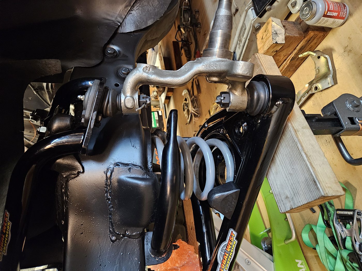

One thing that was brought to my attention about the lower control arms was that they might not have a “bump stop” to prevent the steering from going too far. After bolting everything up, that was exactly the case!! When moving the wheel to full lock, the tire would hit the frame!! I called Global West and was told that, sure, I could just drill and tap the lower arm to accept some sort of stop!! Since I really didn’t want to do that, I asked my neighbor for some help. We came up with the solution of drilling and tapping the steering arm instead and it worked perfectly.

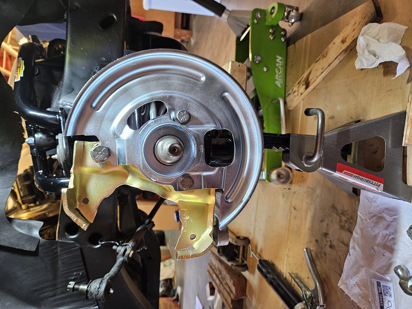

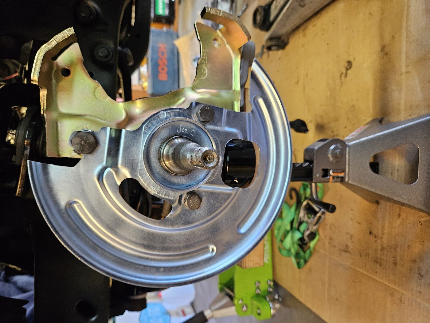

I had the backing plates and caliper brackets replated also.

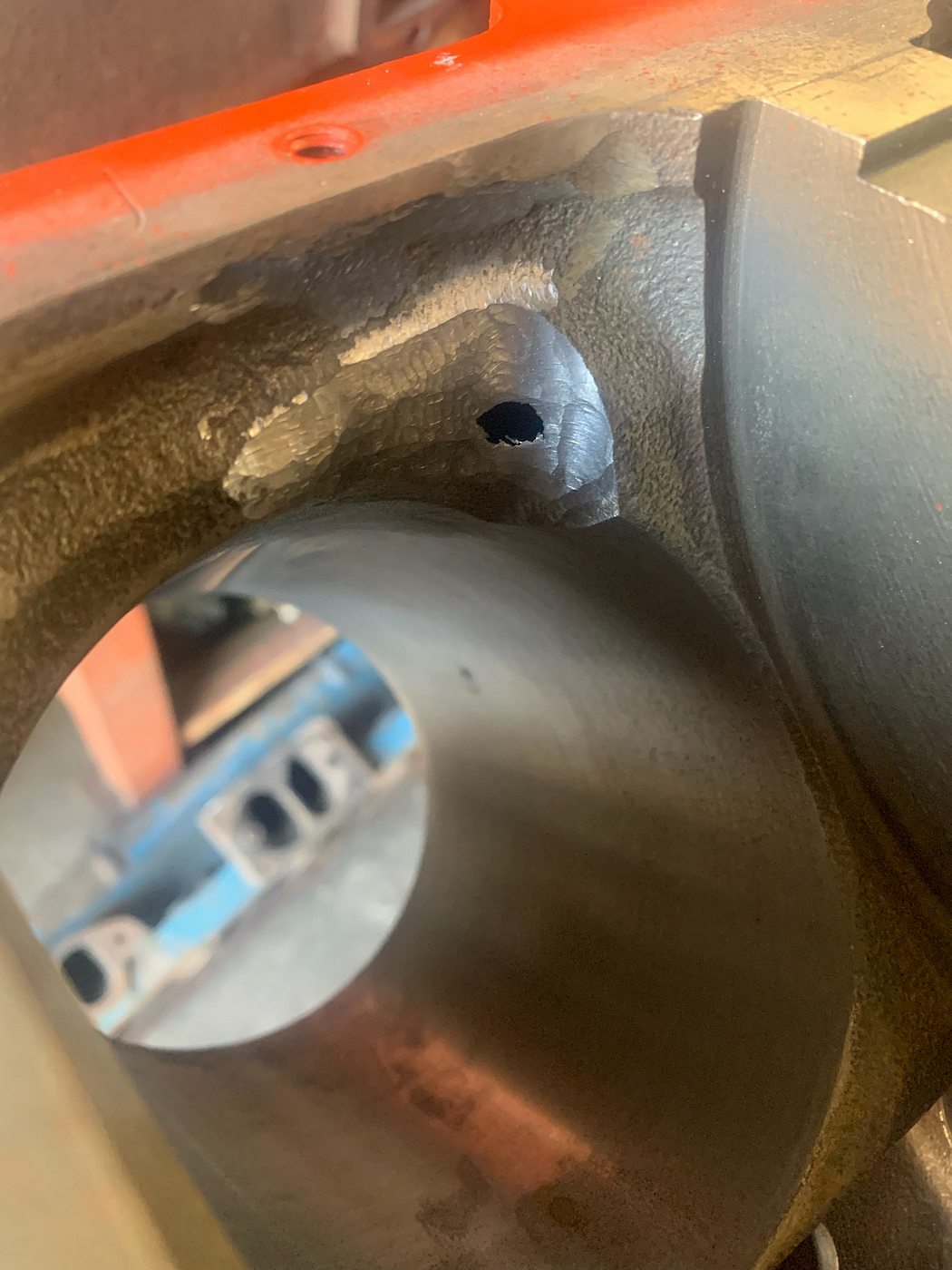

Back to the engine. I had the block cleaned, masked off and painted good old Chevy Orange and then received a text message, with a picture and nothing else, from my engine builder. Who can guess what this is, why it’s bad and whose block it is?? No points for guessing correctly, just know that you’re knowledgeable in things mechanical....
I wish he would have waited until after he was working on the block to have me paint it, but that sometimes happens in the world of engine building?????? He just happened to have another small block laying around from the ‘70’s, had already sent it off to have it machined, and we were back in “business!”

Stroker clearancing in the block that got into water passage?
