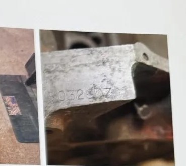

Block Stamp. Rebuild pics.

Stamping looks good, but I wonder why no current pic or pic of the rear axle tube stamping. Just helps the sale. I dont trust anything anymore these days.

That 2nd and 3rd page of McNeish report sums up some suspicions.
Things that I see that raise questions
NCRS says car was built 4-1-69, but rear is dated 3-31?
POP - is it a repop? McNeish questions it. Says dealer stamp is not legit
In the handwritten notes pic 330 - Aug 3, 2003 - new shortblock rebuilt? So is the really the born with engine?
That dealer invoice looks too fresh and made up, MacNeish questions it also.
Was POP made up to match the current drive line? I like the Trans stamp. Engine pad stamp but not sure about the VIN stamp on the engine. I question the 3/31 rear (no stamping pic) in a 4/1 built car.
Kurt S is the expert on POPs
If the POP is in question by McNeish, then you got to wonder. The other docs are suspect.

Agree docs are suspect. I just always assume POPs are repops unless there is some reason to believe they are not. My first Z came with a POP in the glove box. I tossed it, because in my mind "it was no use to me." Most were tossed once out of warranty.
Jerry stated the engine is "original to vehicle."
Not saying he couldn't be wrong. He has been fooled before.

Jonesy what do you think of the engine vin and transmission vin being different fonts? I thought they were stamped at the same time. Jerry seemed to approve it.
