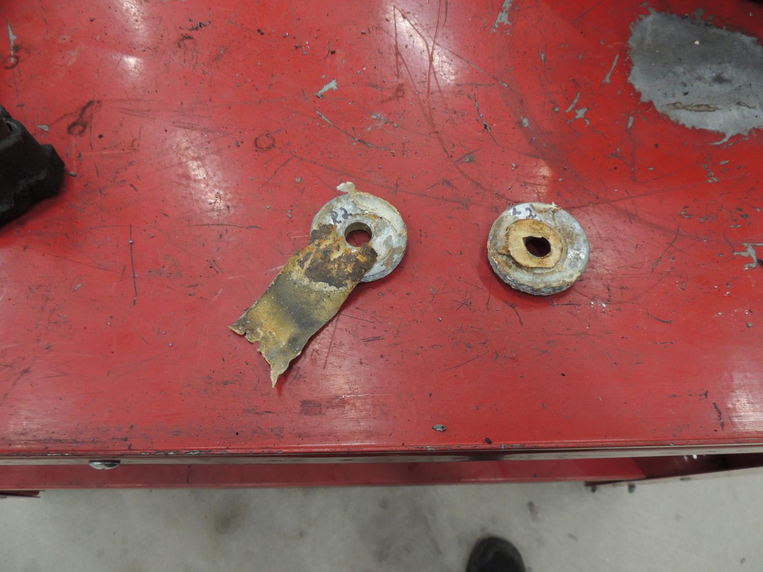

I was shocked to learn that all of the body mount bushings are solid aluminum. I learned that before removing the body, so at least I wasn't surprosed.
Using a mic, they don't seem to be the same sizes. But.... most of them are corroded and swollen.
Were they all the same size or was there some procedure to determine how thick if a bushing to use at each mount? Forgive me if this is in the Assembly Manual. I have one, but it is down at the shop right now. Too lazy to go look.
Also, because the body was not built by Fischer, the Assy Manual is about four times the size of the Camaro AIM!!!!
Next question: is it simply anathema to use hard rubber bushings instead of aluminum? Seems like the aluminum would contribute to squeaks and rattles. You know, the Opel GT of the 60s and the C3 were designed by the same guy. I am shocked every time I drive them back to back how much more solid the Opel feels than the Corvette. That is sad.
Not an easy task you are getting yourself into. There are shims at each body mount. When you remove the body mount, DON"T lose the shims. Record and count each position. The same amount will have to go back in the same spot when you install the body back on the frame..

I have them each marked. Some are incomplete.
When I hear "shims" I think of alignment shims. These are all like large thick washers; maybe 3/8 inch thick. Will post pics Sunday night. Have a work day at the Museum tomorrow.

They are washers, not ALL the same thickness sometimes.
That is what I thought. I don't know how they determined what thickness went where. I am guessing the frames were pretty consistent but the bodies were not so consistent.
This frame has enough rust on it that I am not planning to repair it. I have a donor rust free frame that I have already stripped down. One little area needs attention, but zero rust. All the caged nuts (and the cages) are in great shape. Just need to chase threads.
Found this post on the Corvette forum (see post #5).
https://www.corvetteforum.com/forums...unt-shims.html
