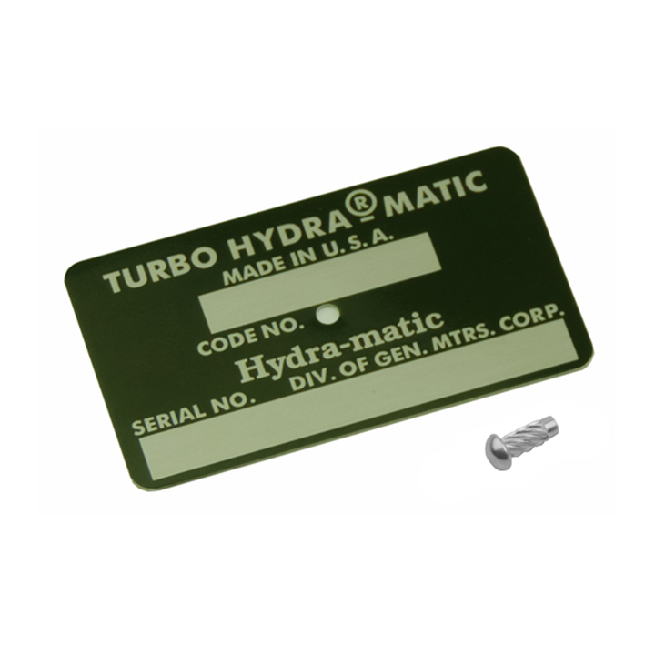

Can you help me understand how to remove the ID tag?
I can't figure how to remove the rivet.
  #12
Old 06-26-2023, 08:29 PM
Posts: 21,084
Thanked 3,938 Times in 1,548 Posts
Take a pair of Vise Grips and try to grab as much meat of the rivit head as possible,(try squaring it with a file beforehand),then twist & pull out very slowly.
If it's really in there and won't release,drill it out with a slightly smaller drill bit.
