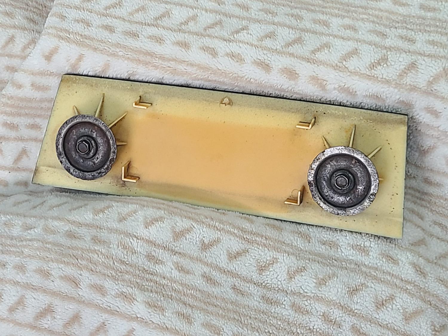

There is a plastic bracket at the top, Bill, but the top edge of the panel slides down into it.
And I'm wrong about the bottom, there are 4 screws...

Thanks for the info! I am specifically wondering how the delete panel attaches to the actual dash panel? I've replaced the larger center panel twice actually. I learned something new about 67s today when I saw this car with the radio delete panel so it has me intrigued as to how it is fastened in place.

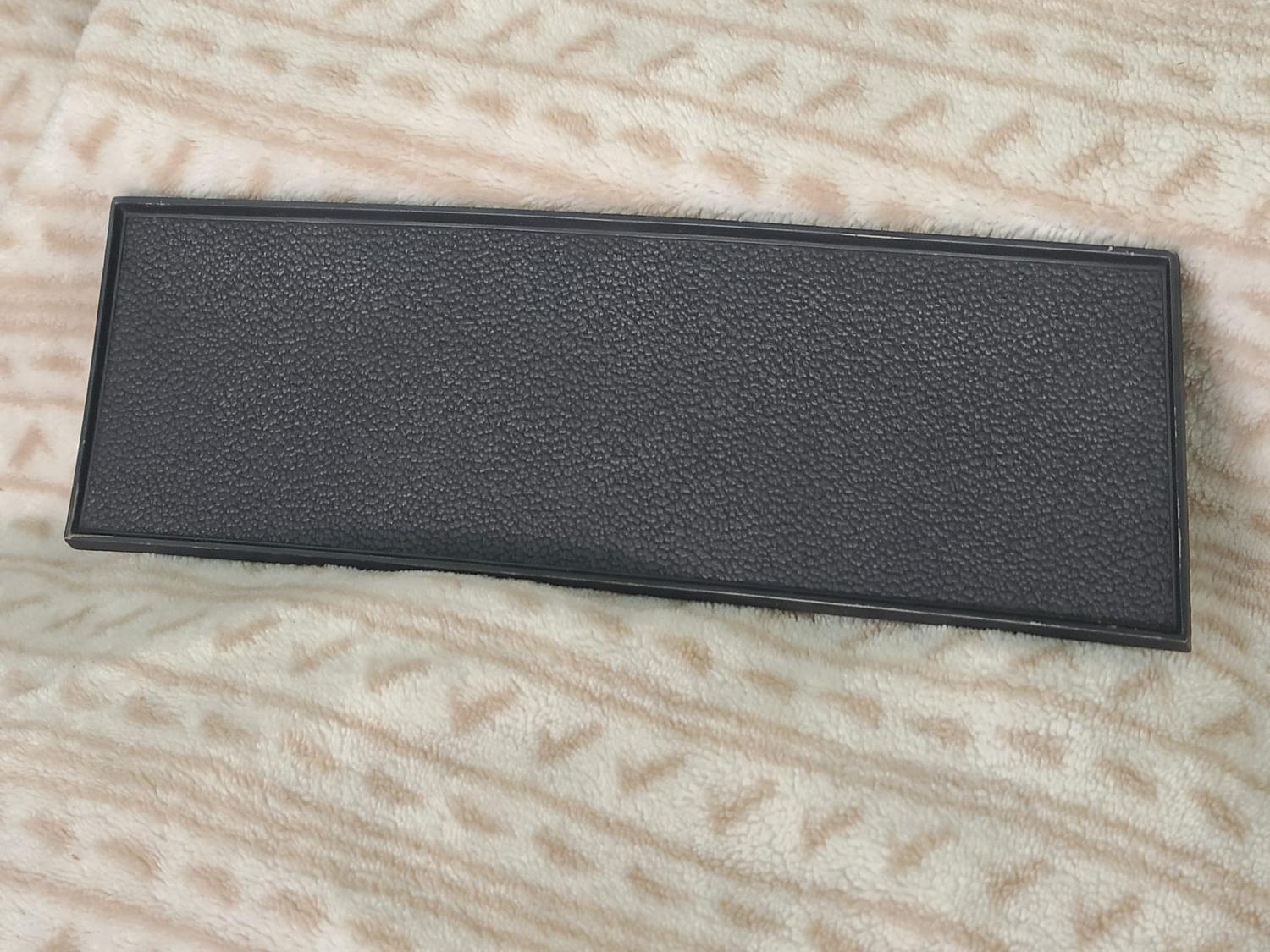

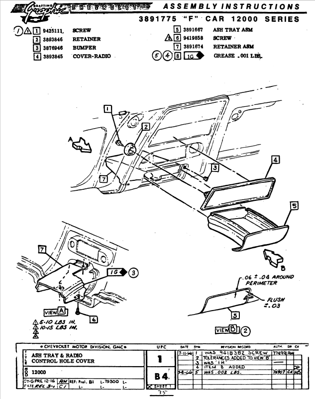

This is an original GM Radio cover plate.

The pic I posted is a repro, radio delete face plate, but it's all 1 piece, not like original with an add on plate for the radio hole. Top hole is heater controls and bottom is ash tray.

Does any company make a dash radio repair panel for 67/68 Camaros? The only thing I see is the entire dash assembly. Looks like I'll have to repair the dash anyway to use this delete panel.

Since you are just going to cover the area, I would fashion a panel by hand from sheet and weld or rivet it in... It only needs to hold the delete plate.
