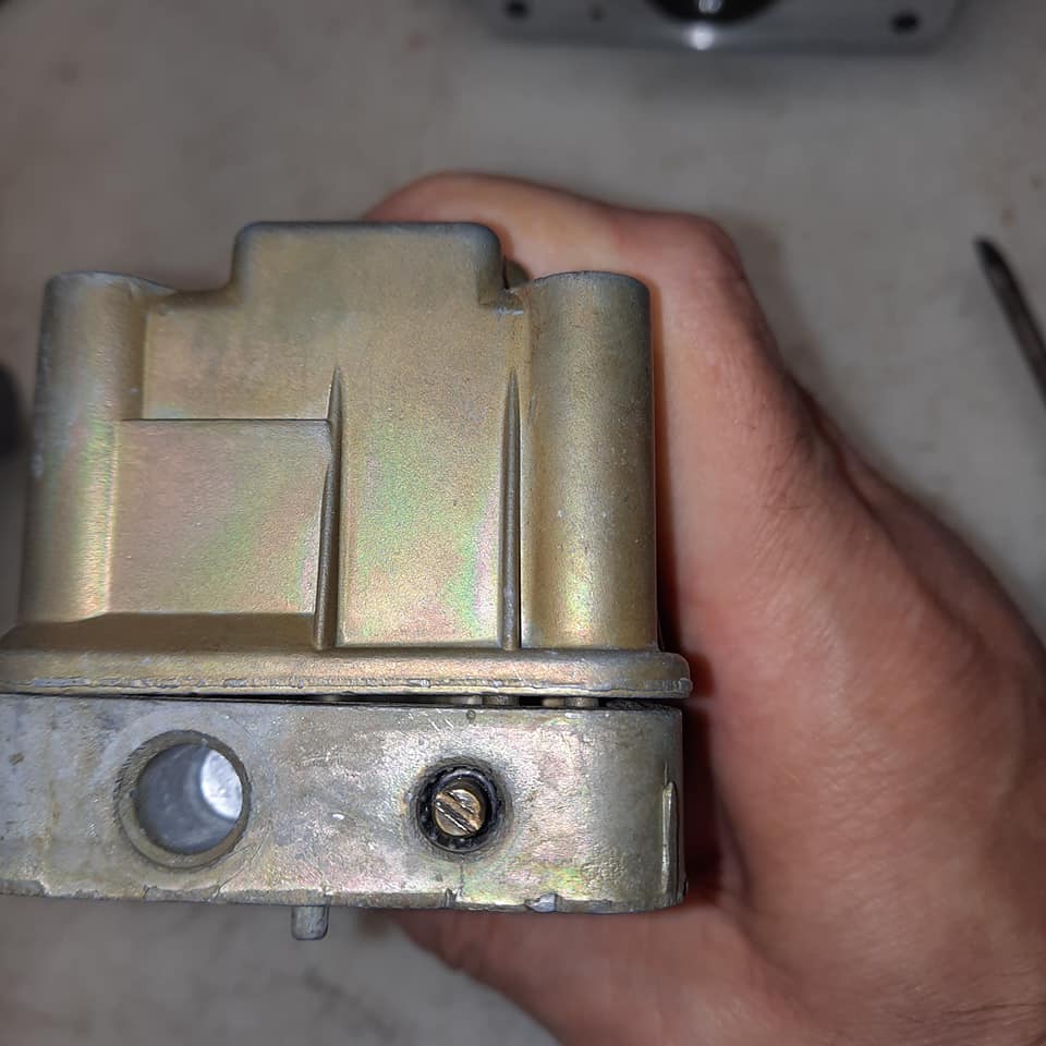

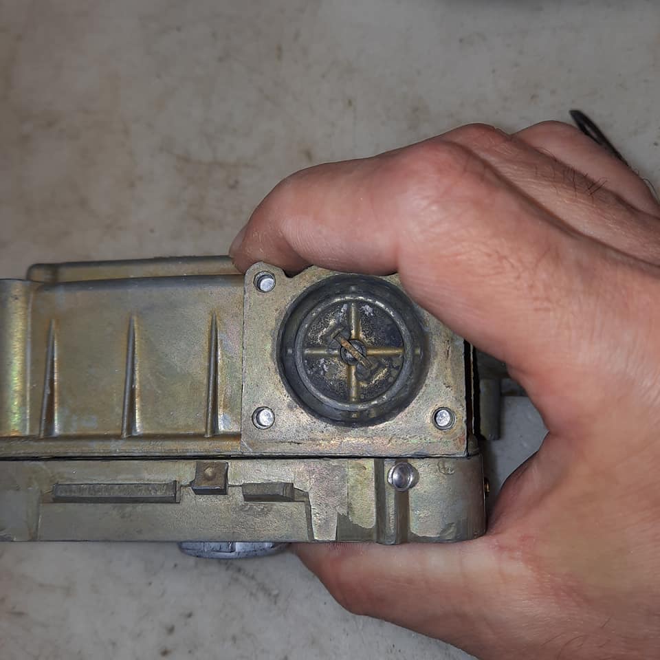

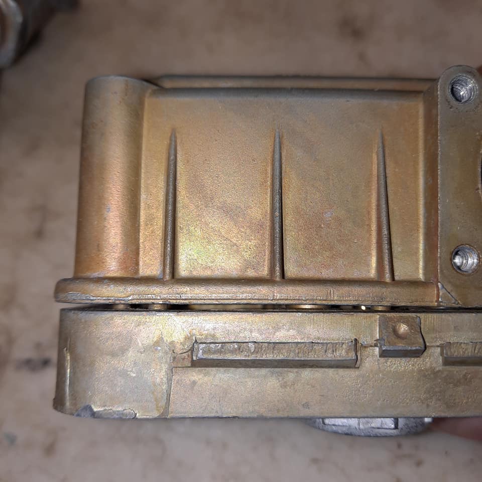

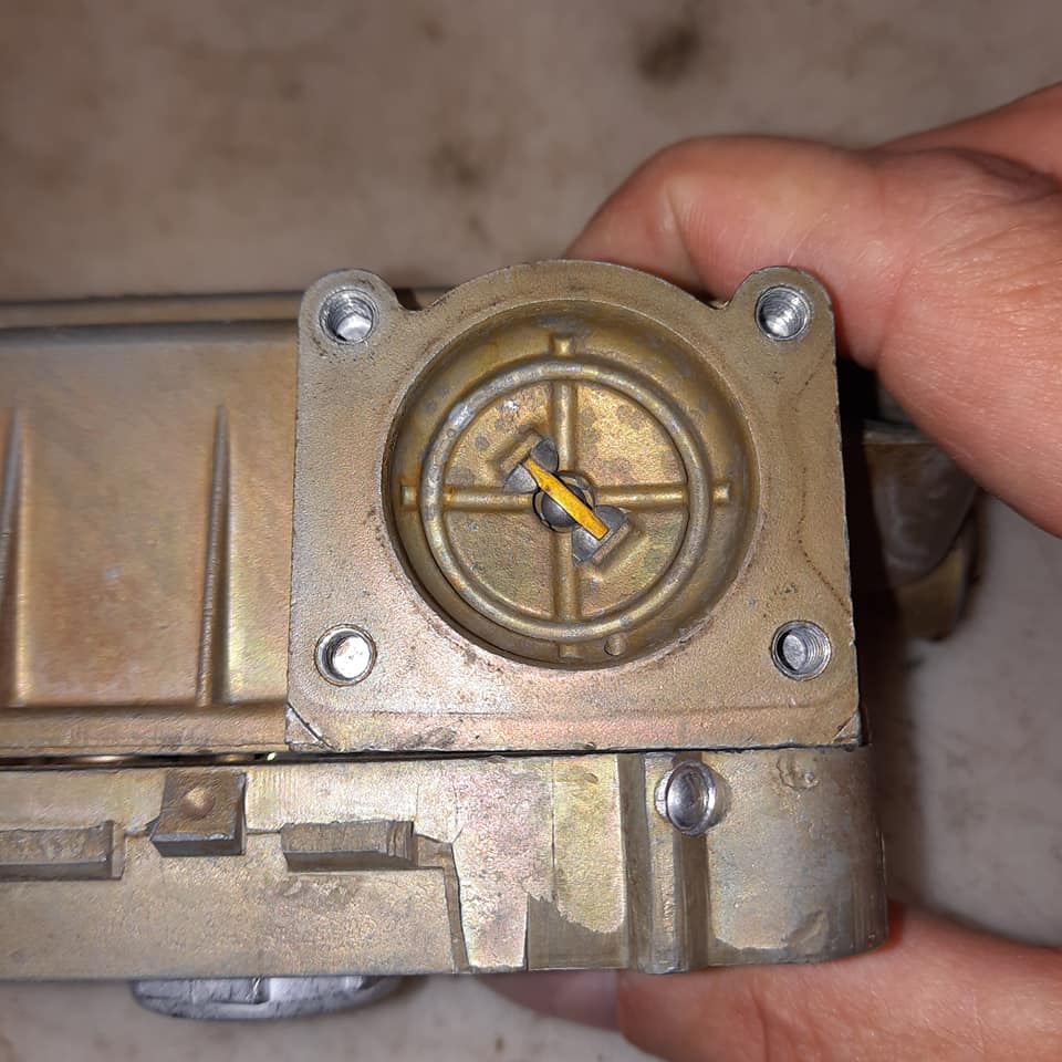

Napa what do you mean when you say the float bowl was out .090
Warped......

Thanks Napa. Just had mine apart and never thought to check that. Be on the list next time for sure
