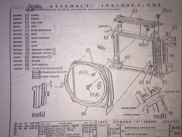

Not a Chevelle guy here, but, does the factory assembly instruction manual show the petcock as an individual part OR as a part of the radiator assembly. If shown separately, I'd say no paint. If part of the assembly, odds are it was painted.

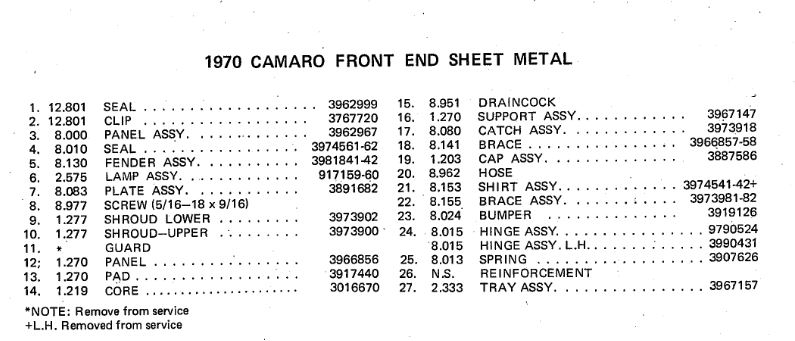

Still speaking to workers that worked at Norwood plant going through the validation on this issue.
In the mean time for your consideration:

Those of you with a copy of Echoes open it to the 2nd floor assembly print and with a magnifier you will locate the radiator conveyor. This is adjacent to the "dog house" front end "buck build" area that supplied sheet metal drop.
I am wrapping up the validation and will post the conclusions in a couple of days.
Here is the AIM:

Nan here is the drain cock called for in 1970. For some reason GM decided to use a drain cock primarily used in trucks dating back to 1963. Construction is brass.
