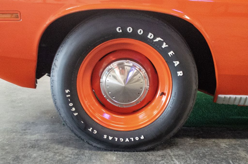

Yes the '450' steel wheel was a 15 incher wrapped in the same F-60-15 Polyglas GTs

The '450' (last 3 digits of part number/casting number) wheel commands a steep price today - restored sets can be $4000-5000 for date matched items, for something that got pitched in the scrap heap back in the day in favor of cool mags. Many Hemi car restorers cheap out on this item and try to pass off the shallow offset version with the narrow band (where valve stem sits), and when you know the difference it sticks out like a sore thumb.

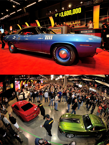

$3.5 million Hemi Cuda convertible going across the block with the wrong (cheap) non - 450 wheels. Note narrow inner band and too-shallow offset which sets the hubcap too far out

Could’ve got 3.7 with the right wheels

Says the car sold in 2008. Dave C. Sold his collection at Mecum Indy that year and had a black one with the red body side moldings.

Tracker 1 you are right. The wrong wheels stand out like sore thumb. Never noticed but man when you bring it up definitely looks crummy with the shallow wheels.
