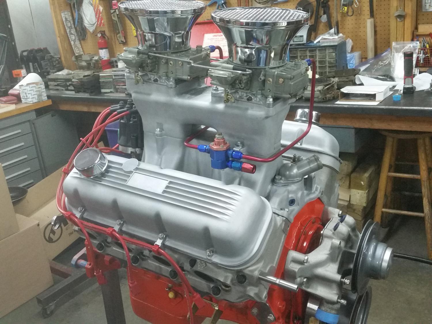

Originally Posted by smallblockhero View Post
interested in your wire holders... very nice , very clean.. may i ask where i can find these?
I made the aluminum parts. The plastic parts are from a Made For You kit.
Freddie
