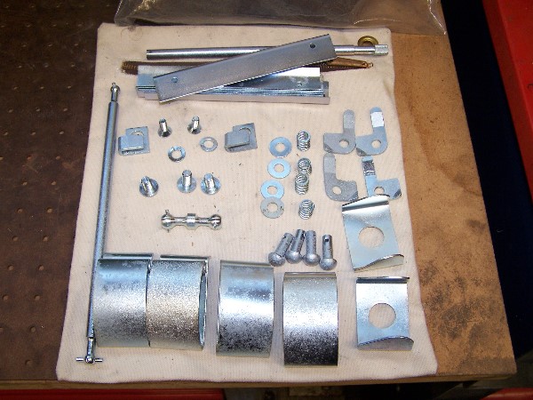

Zinc Plating: Before and After

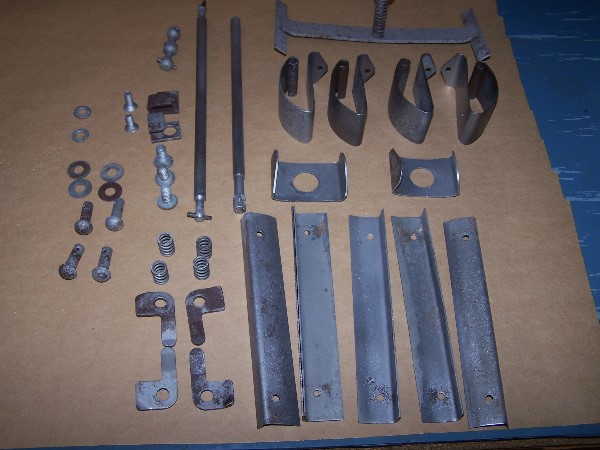

69 Los Z11

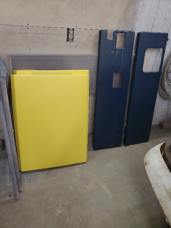

Colorized Primed panels.
Paint is HOK line

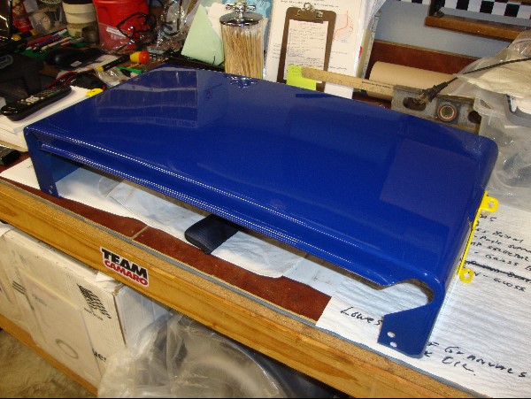

Gas Pump Lid (Top Panel)
I elected NOT to install a Globe at this time, It should be an easy Mod to accomplish at a later date.

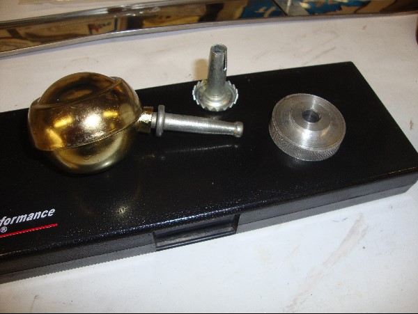

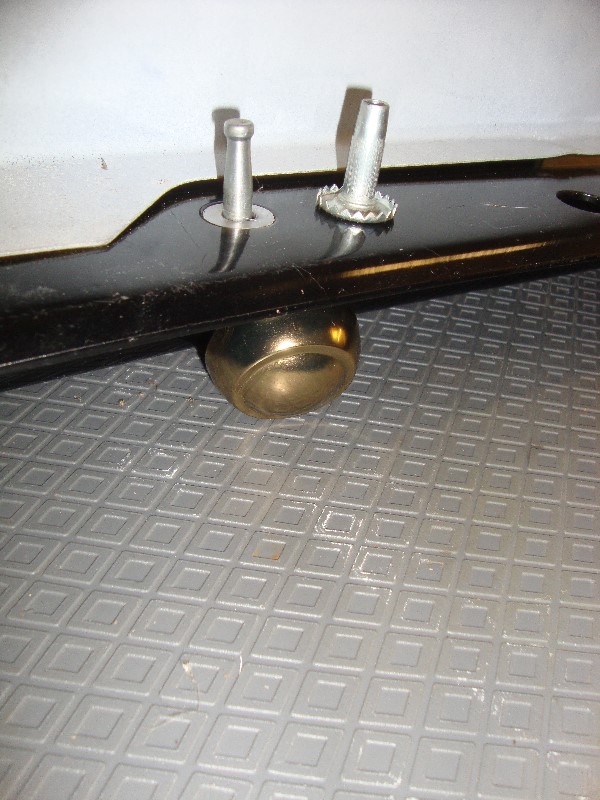

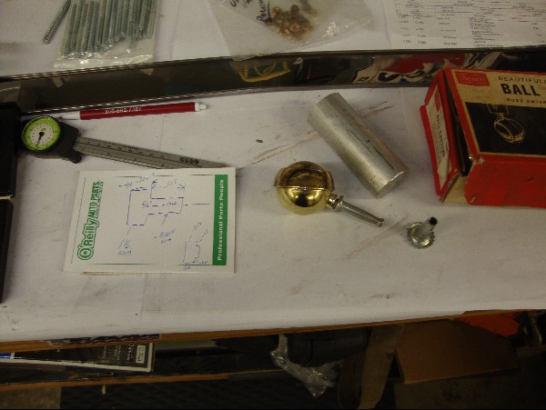

I found a vintage set of Sears Metal Ball casters in Dad's garage and figured a way to adapt them to the gas pump base existing holes. I sourced alum round stock and machined adapters to allow the stems to be capture held in place with the Pump hovering around a 1/8" above the ground. This keeps the pump stable yet allows for controlled movement on a very flat concrete garage floor for maintenance and cleaning purposes. The holes are to close to the side so the casters are not able to swivel the full 360 but nonetheless it still works nice. Fun little project that put Dad's good Old (Vintage) Craftsman (Atlas) Lathe to use.

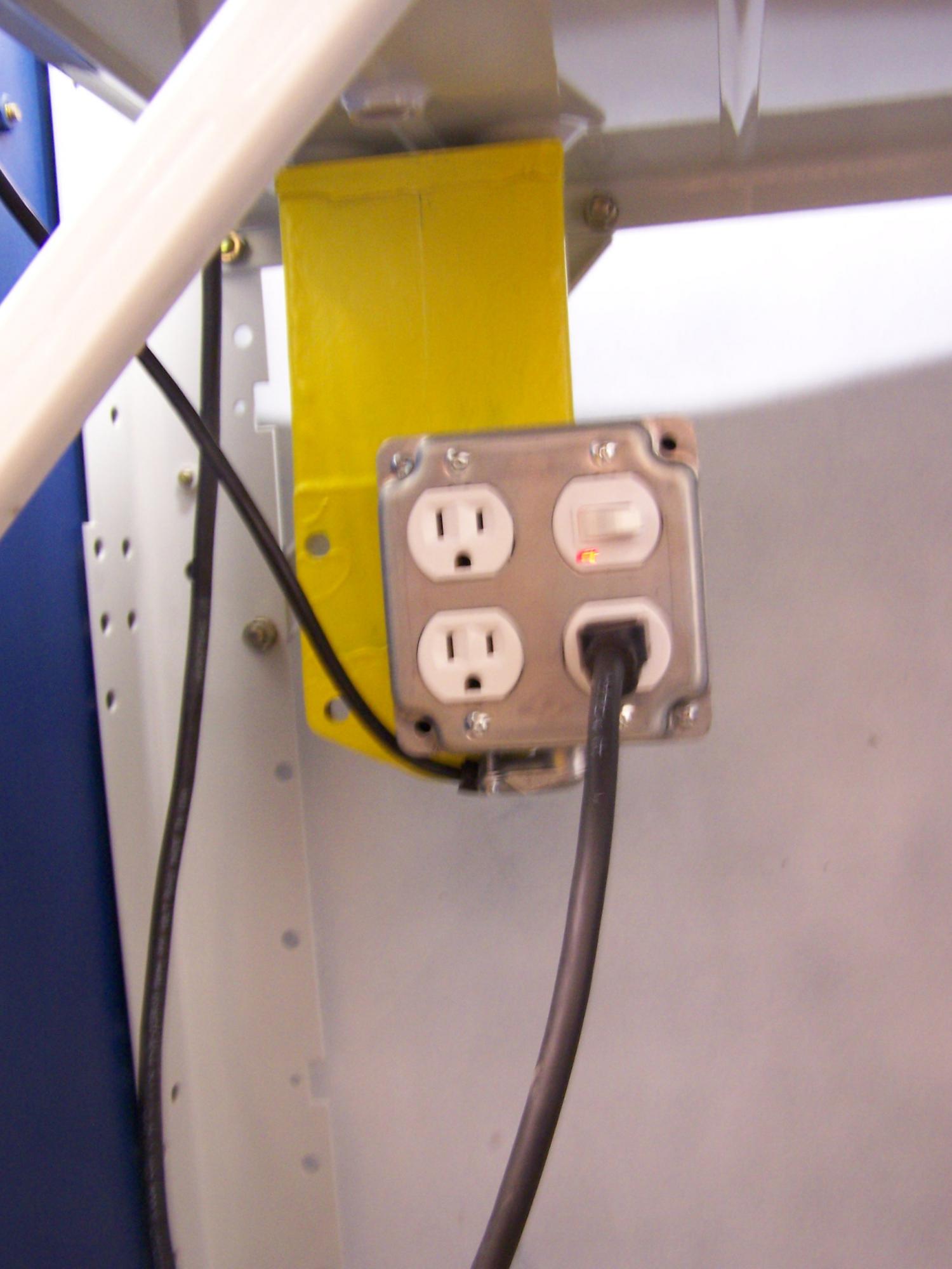

Added an internal 120vac hot and switched receptacle; power for future globe and "animation" of the dual fuel-flow rotary indicators.

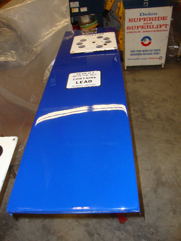

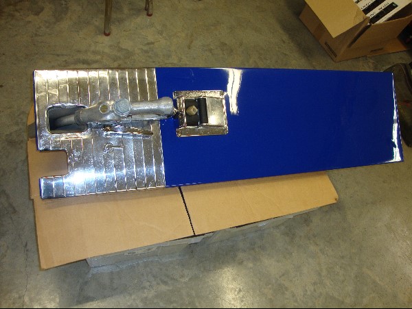

More Progress; Side panels, Assembly, DIY polish of stainless steel & attaching selector, Should be Yellow or Chrome, I chose to keep it in the Orig enameled "white"
