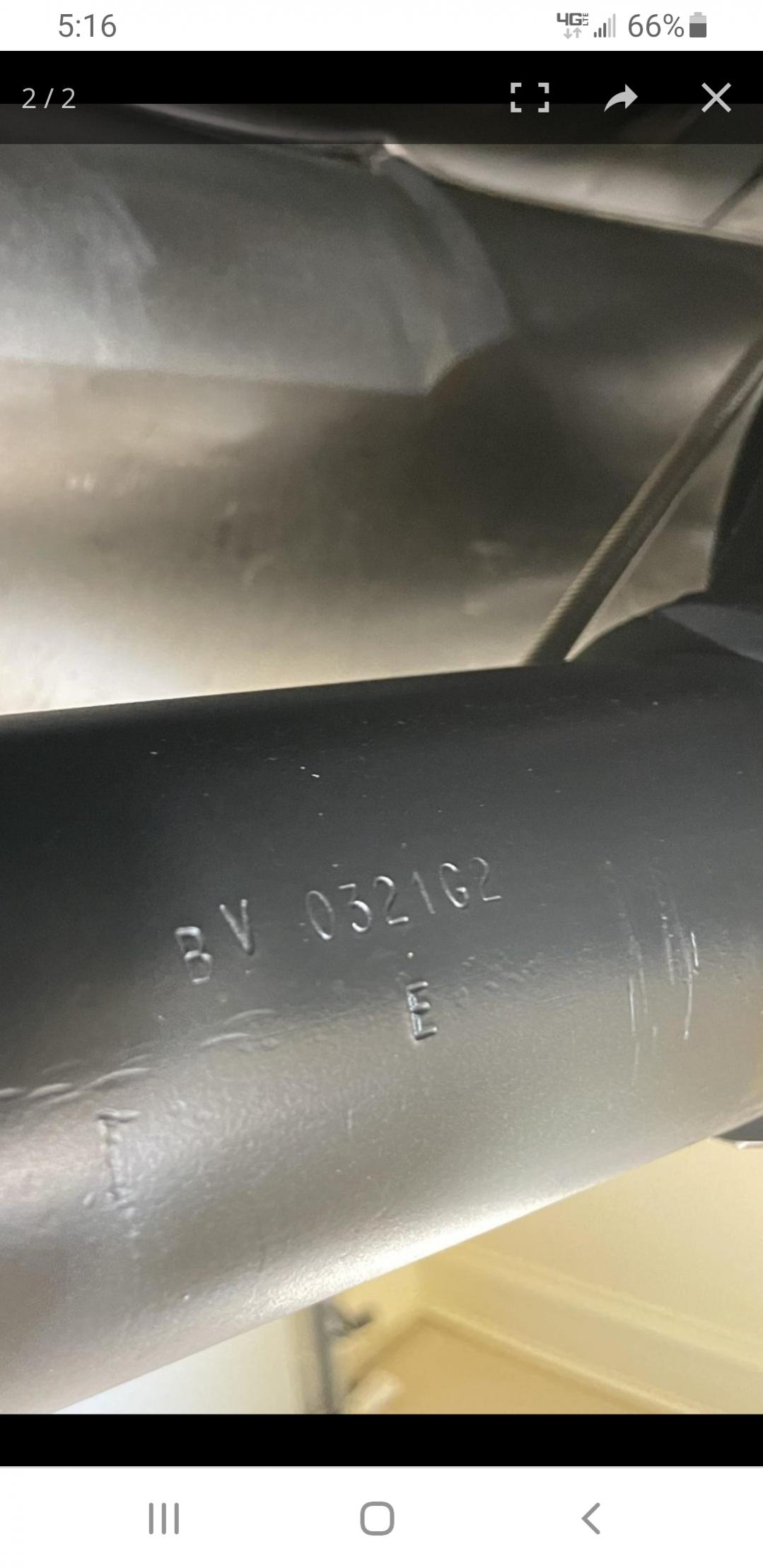

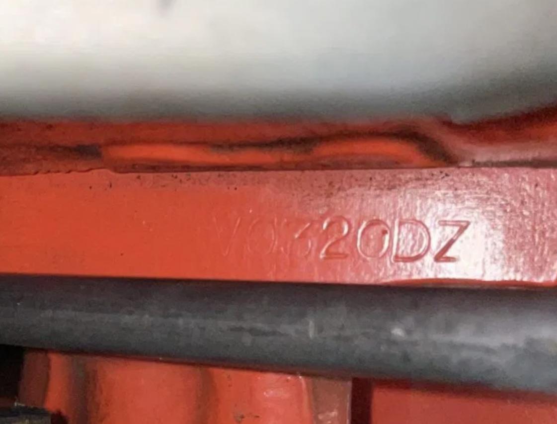

There are a few errors like the space-saver and the cowl seal, but otherwise seems like a pretty well-done car? Not exactly uncommon for the cowl tag to be replaced in older restorations, sadly.
Here are the block and trans. BV rear seems like the right date.

My 03D axle is the 25th.

Those driveline stampings look legit. I would say that hes lucky he found that original cowl tag.

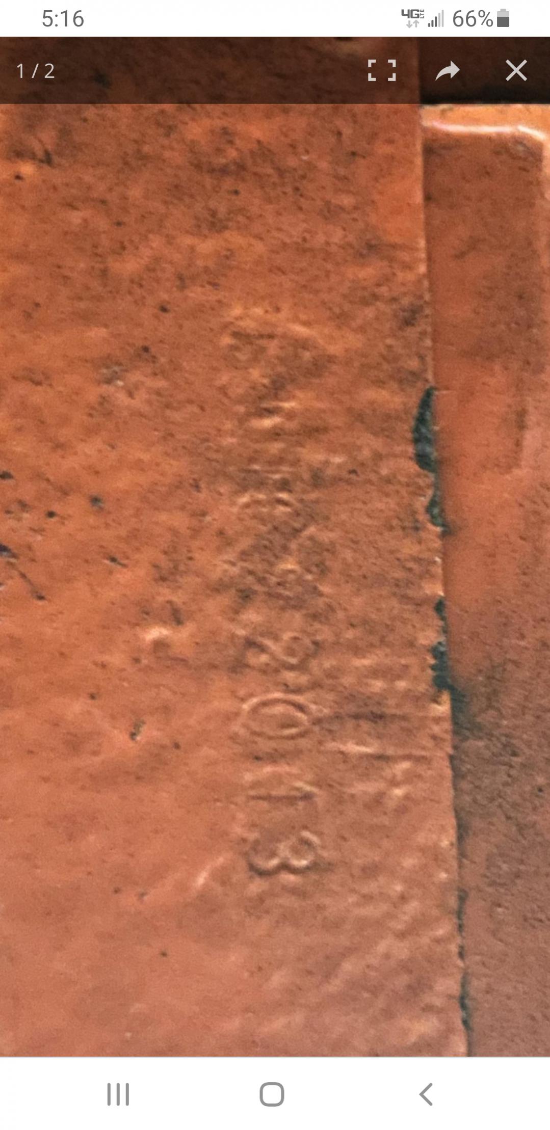

Body number is the same on both. I would like to see the pad stamping bare, but initial thought is that its good.
I think that original cowl tag was on that car. What would be nice is to find a pic of it attached to the car pre restoration.

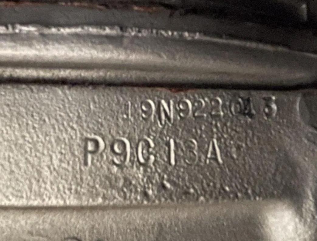

That transmission stamp still looks kind of weird to me - at least the VIN portion.
