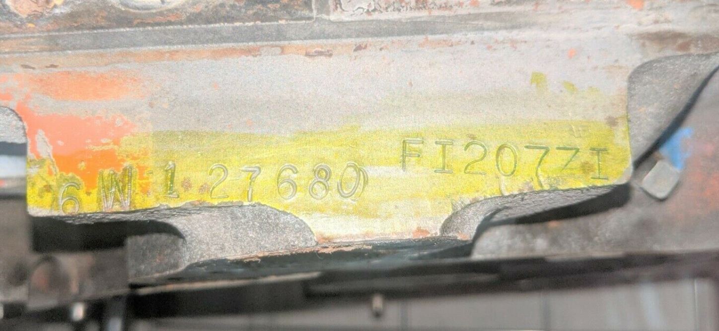

Stamp pics are in the eBay ad. What do you experts think about them?

I have seen some pretty ugly partial VIN stamps on other ‘66 Chevys - dug through my files and didn’t have anything close to compare to, unfortunately.
This new ad is 1000x more helpful than the first.

The pad is not exactly like the couple l-79's I found sitting since 1970 and earlier, but similar enough to say it's real. There's an old thread on this site regarding a L-79 wagon that was on Ebay, and the picture posted of the stamping was dead-on like the two I owned.

Stamp is 100% legit.

Pic of the pad for posterity's sake.
