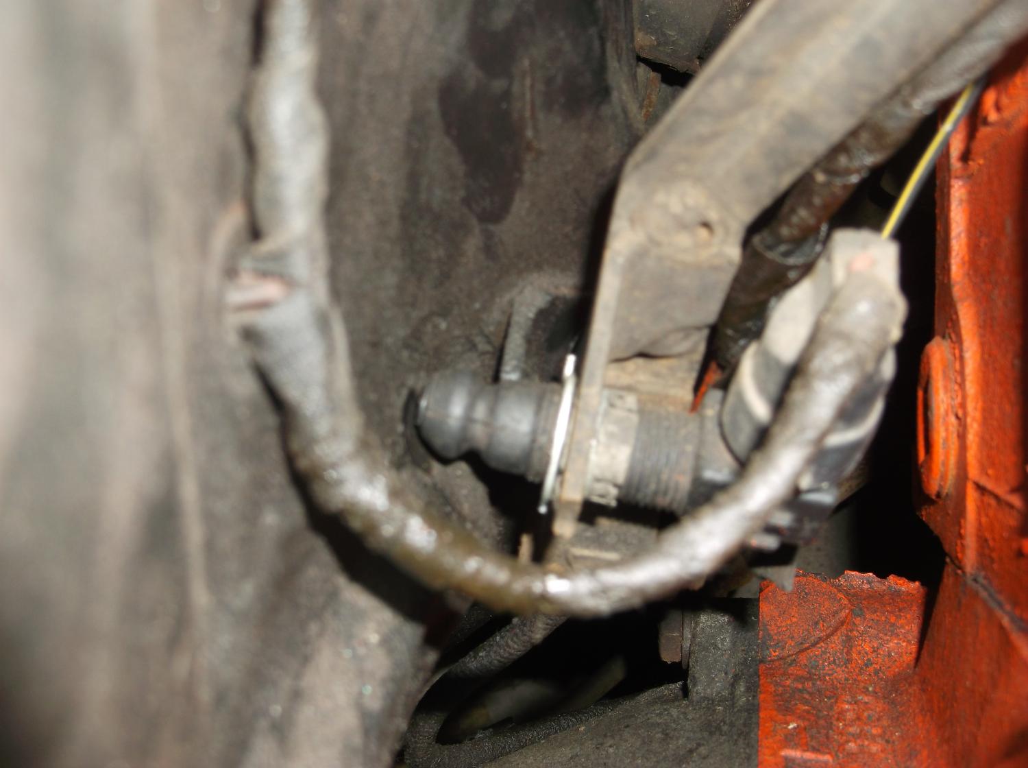

Warren,
I have never seen that clip, my 06A Z does not have it , I have owned the car since 1974, factory ZL2 car, the GM #9788460 switch clip has 3 lip serrations that captures the plastic threads on the switch . Is that a recall or did they all have them?

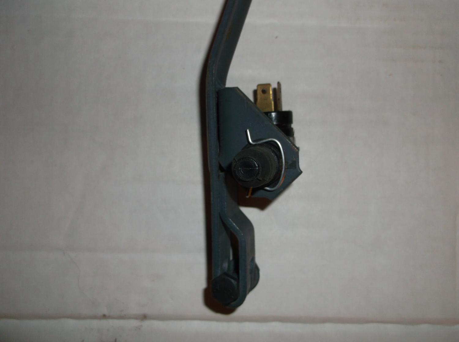

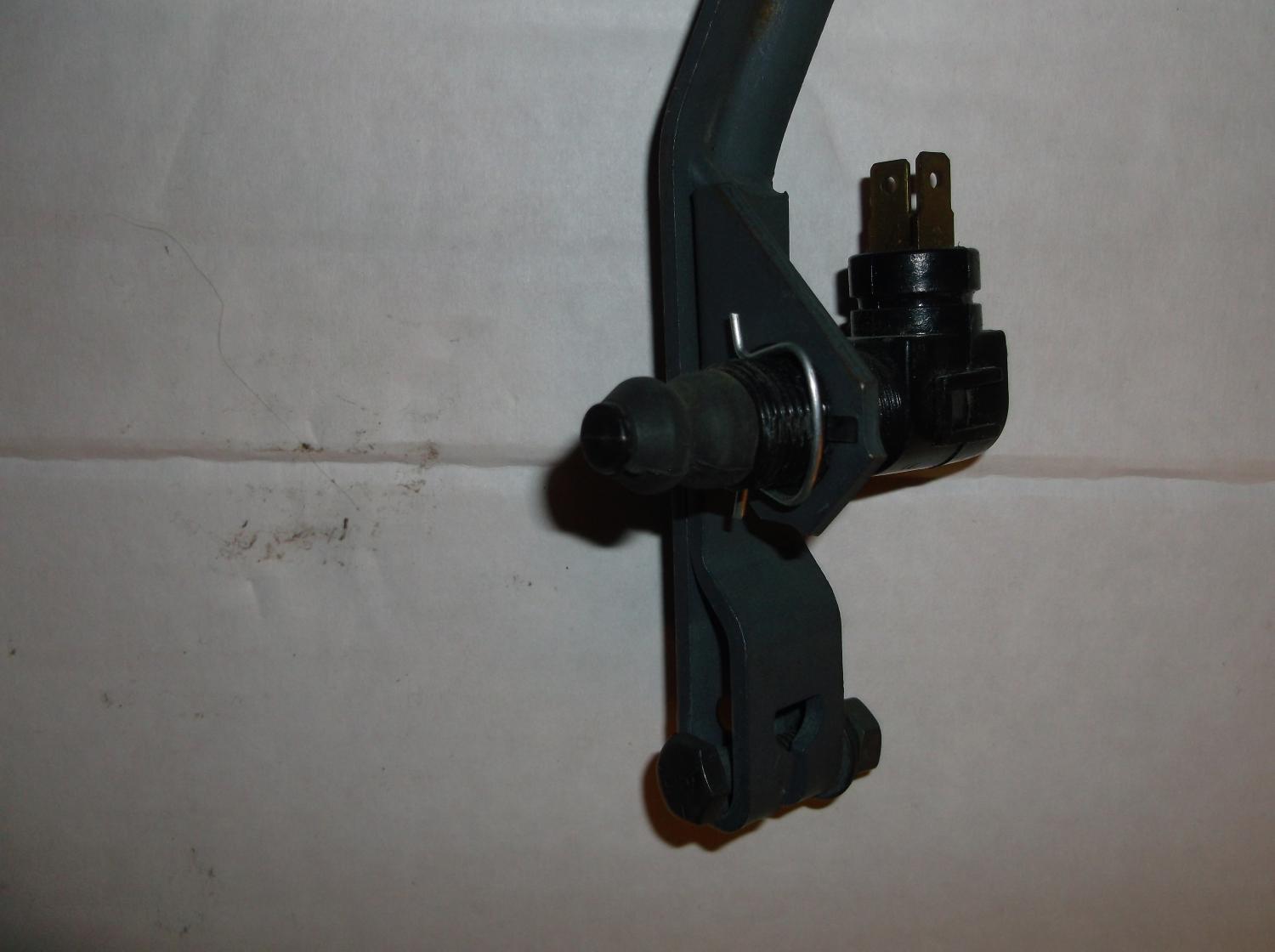

Your car is suppose to have it. Whether it was installed when the car was new, no one knows.
Clip number 2 in the assembly manual, is like the one that you show in your picture. That holds the switch in place.
The window crank clip (number 5) locks the switch in place to prevent it from moving backwards.

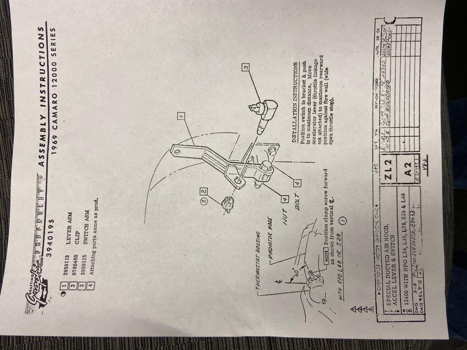

It says 5-21-69 Item 5 added. So maybe it came on later cars??
Funny that the AIM I have used for reference doesnt have this clip shown in the pic.

I took pictures off of my 07A build car which shows the clip installed. Also, took pictures of one of my spares.

Here is what I was referencing

I also noticed the AIM shows the nut on the throttle arm towards the firewall, but most of the pics i have seen on cars shows it facing the engine
I have learned not to trust the aim explicitly, I have found lots of discrepancies over the years comparing to survivor cars.
As far as the bolt I am pretty sure that it goes into bind on the firewall bracket if its installed as shown in the aim diagram.
